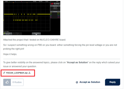

I tested your project and I probed CAN frames on Tx without any issue and the Rx callback is also triggering.
This is a screenshot of CAN frame on PB6:
Attached the project that I tested on NUCLEO-G491RE board.
So I suspect something wrong on PB6 on you board: either something forcing the pin level voltage or you are not probing the right pin!

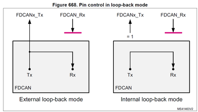

3. Was FDCAN_TX and FDCAN_RX shorted while testing?
-> No. The connection is done internally by hardware when configuring it in loopback mode. Please refer to the reference manual of the product:
