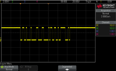

We are currently working on STM32G491KCU6 MCU FDCAN side. Our requirement is to validate the activity on Tx and Rx pins.
We started off the testing with the LoopBack mechanism but unfortunately we were not able to see any data received in the Rx buffer. We referred sample FDCAN programs for this and tested the same in STM IDE Debugger mode.
We then moved to test the normal mode as well. For this we used a sample code and probed the Tx pin of FDCAN using an oscilloscope. During the transmission, no activity is seen on the oscilloscope.
We confirmed the pins are not damaged by setting FDCAN_Tx and FDCAN_Rx pins to GPIO and toggled it.
Please let us know what we have missed and guide us.

I tested your project and I probed CAN frames on Tx without any issue and the Rx callback is also triggering.
This is a screenshot of CAN frame on PB6:
Attached the project that I tested on NUCLEO-G491RE board.
So I suspect something wrong on PB6 on you board: either something forcing the pin level voltage or you are not probing the right pin!
Hope it helps.
