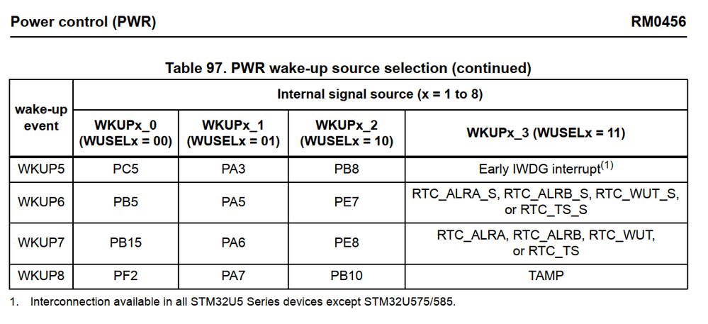

Making some test and research I find what was the problem.
I Know that after Standby all is like reset with some exception but I was unable to wakeup again.
With the following code all It's working
HAL_RTCEx_SetWakeUpTimer_IT(&hrtc, 3, RTC_WAKEUPCLOCK_CK_SPRE_16BITS, 0);
HAL_PWR_EnableWakeUpPin(PWR_WAKEUP_PIN7_HIGH_3);
HAL_PWR_EnterSTANDBYMode();
The only think I don't understand is
why It's needed and is not documented ? I find that solution in another thread in the forum ( Link1, Link2 )
Inside IDE configuration there is the following section inside PWR
has something related? If I select WakeUp7 I only see interrupt pin PA6
Why inside IDE there isn't something related to RTC?
Can someone explain better?
