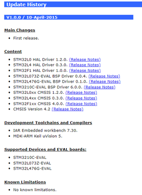

Then, I checked the possible IAP implementation and I reached the AN4657, but it seems quite old and without CubeIDE examples or latest STM32 MCU families implemented:
- Is there any update for STM32U5 IAP examples?
