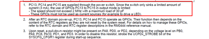

We have an output that is internally pulled down and configured in push-pull mode. I’ve read that setting the GPIO output speed too high could potentially lead some issues mentioned below:
"The output speed register only affects pins which are configured as outputs. It controls the slew rate (drive strength) used for the output. Using an excessively high speed may cause ringing and EMI on outputs, so it is important to use the minimum speed required for your application"
Could this be related to the issue I’m experiencing?
Your problem is a short on (1 or more) pins - or a killed cpu. (Overvoltage...or ESD can kill it easy...)
not (too) high speed on any pin.
I reviewed the datasheet and discovered in (Table 11. Pin assignment and description) that using PC13/14/15 has output limitations in certain cases. However, in my design, PC13 is configured as open-drain output with external pull-up resistor.
Could this be the cause of the malfunction?
Unlikely.
The limitation there is just about sourcing current, not sinking - see:
https://community.st.com/t5/stm32-mcus-products/stm32f030-pc13-14-15-current-sink-limits/m-p/721081/highlight/true#M261048
Open-drain can only ever sink current.

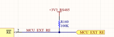

Hello everyone, after reviewing our design, I discovered an unprotected pin that is connected to the chassis ground of the device. I’ll need to check if there are any other similar pins. It must be the problem.
In this case, you better provide more information. In special the (important parts of the) schematic. A new thread is a good idea - with linking here to it.
