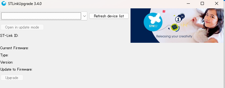

Then I tried to upgrade ST-link.
But there's not any device to upgrade.

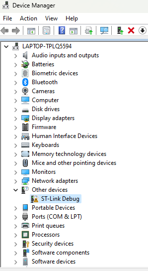

So I also saw Device Manager.
And I found a something to caution.

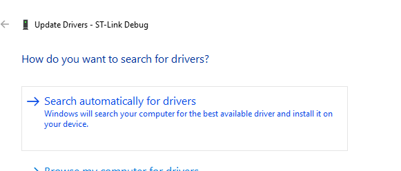

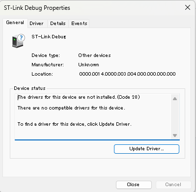

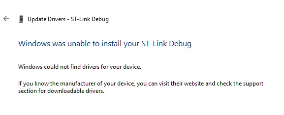

Then Cricked and tried to search the drivers of ST-link Debug.

Uninstall drivers, rebooting, installing drivers, rebooting, then connecting the boards may fix it.

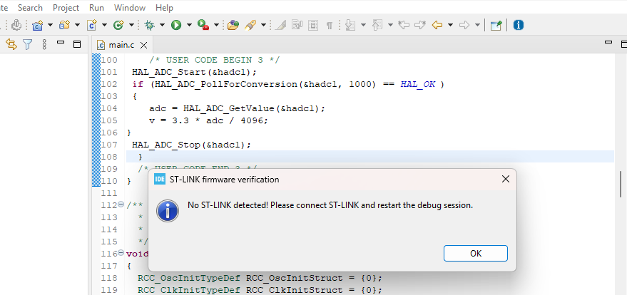

Cricked this icon to debug.
But this caution popped up.

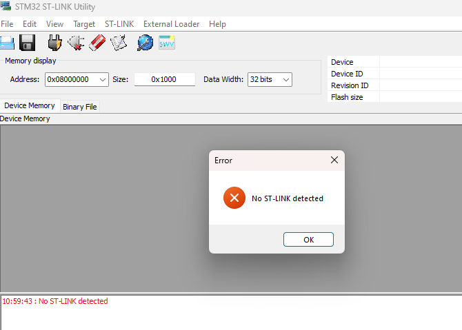

You mean ST-link utillity?
I cricked this.
But this caution appeared.
Peter BENSCH
The ST-Link utility has not been recommended for use for a long time, which is why you should remove it from your tool pool and your memory.
But your STLinkUpgrade would also benefit from an upgrade from the hopelessly outdated version 3.4.0 - presumably you are still using an old version of STM32CubeIDE?

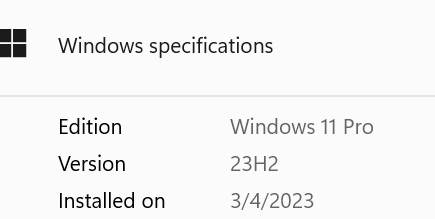

What version of Windows are you using on your notebook/laptop?

Windows version is below.
I had issues with Nucleo boards not being recognized on my home PC after I did an update to STM32CubeIDE. I tried to go back to the original version that i did have working but the Nucleo still wasn't being recognized. I had to use my work laptop to code on the Nucleo.
I think after some latest updates, 3 or 4 weeks later, I have been able to successfully connect to the Nucleo. Version 1.13.2 is currently the latest I haven't had any issues as of lately.

download and install actual version of stm32CubeProgrammer.
https://www.st.com/en/development-tools/stm32cubeprog.html
it should install needed drivers also.
at least - on my laptop with win it worked.
of course allow all "dangerous" or "illegal" access , if win asks about - otherwise you never get drivers installed. :)
try to connect with stm32CubeProgrammer first !
