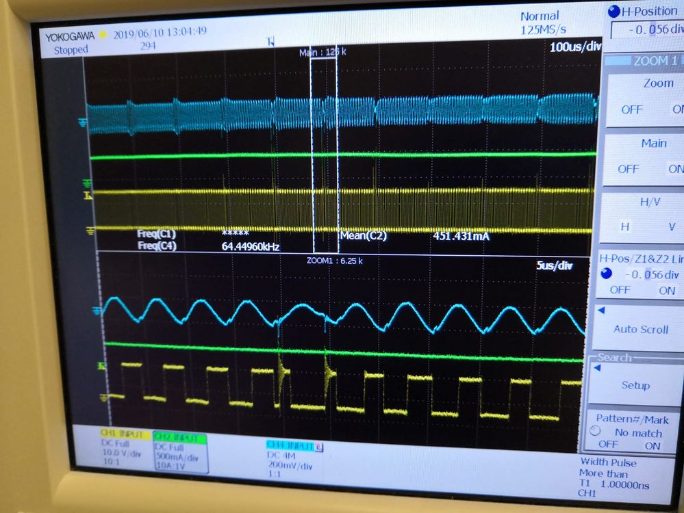

Hello, Community.
I am currently trying to control a power converter with a STM32F4 microcontroller. The thing is that the control variable is the frequency of the PWM. I have programmed a timer (TIM3) that generates an interruption every 100us. During this interruption, the MCU has to calculate the new frequency value of the PWM in order to switch the power MOSFET.
I tried two options but none of them work as I want.
case a) Modifying the ARR register on the fly.
If I do this, I have seen that many times, the PWM doesn't work and remains at high level during a certain time (400us or so). Please, kindly see the yellow pulses. It obviously has effects over the power converter.
case b) I thought that since the register is not updated inmediately, I could reset the counter of the PWM timer. This time, the PWM no longer remains high during a certain time but it provides strange pulses.
TIM8 -> CNT = 0;
TIM8->ARR = "calculated value";
I read about diferent registers to make the updates of the registers inmediately but I am not capable. I tried many things but they don't work.
Could you give me a hint? Thanks a lot.

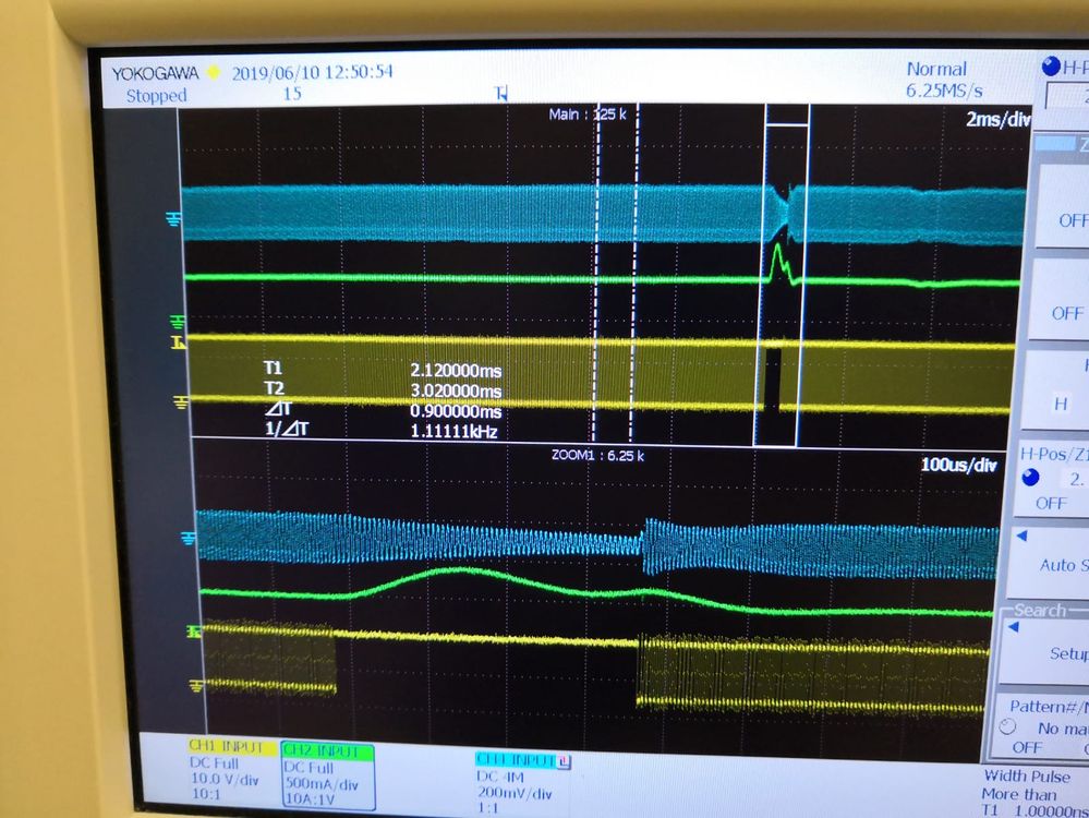

quintanabarcia.pablo
I have tried one simple thing.
Every 100us I change the frequency of the PWM by modifying the ARR register just by adding or substracting 10 to the original value. And every time the microcontroller does the same as in picture 2. The very first 2 or 3 cycles, the pulses have wrong duty cycle.
