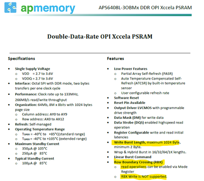

@Alex - APMemory I am trying interface APS6408L on the B-U858I-IOT02A Discovery Kit in OSPI DTR memory mapped mode for both read and writes. The datasheet for APS6408L mentions that the page size for it is 1Kb.
In the memory mapped mode, is it possible to write in a chunk greater than 1Kb for the RAM? I am read this for the memory in the datasheet,
"Burst Type & Length
Read and write operations are default Hybrid Wrap 32 mode. Other burst lengths of 16, 32, 64 or 1K bytes in
standard or Hybrid wrap modes are register configurable(see Table 20). The device also includes command for
Linear Bursting. Bursts can start on any even address. Write burst length has a minimum of 2 bytes. Read has no
minimum length. Both write and read have no restriction on maximum burst length as long as tCEM is met."
I am using memcpy for writing the data in the memory mapped mode. My question is, is it possible to write in blocks greater than 1Kb for this memory?
-Rikesh
20 replies
Alex - APMemory
April 16, 2024
Hi Rikesh,
Maximum Write is 1 page (1024Byte for 64Mb, 2048Byte for 256Mb), and not limited for Read (RBX), subject that maximum burst length as long as tCEM is met.
I hope this help to reply to your question
Alex

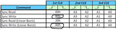

@Alex - APMemory , Thanks for your prompt response. I was assuming that the maximum write burst length of 1024 is only applicable for linear burst write(A0h). Is this true for sync Write(command 80h) as well.
I was using memory mapped mode and trying to write data using etl::copy functions,
                volatile uint8_t* flash_ptr = reinterpret_cast<volatile uint8_t*>(OCTOSPI1_BASE + address);
                etl::copy(data, data + size, flash_ptr);
Does the maximum write burst length limitation of 1Kb apply to all the write modes,
both indirect and memory mapped modes?
-Rikesh
Alex - APMemory
April 23, 2024
To your question:
  1. I was assuming that the maximum write burst length of 1024 is only applicable for linear burst write(A0h). Is this true for sync Write(command 80h) as well      =>Yes, the operating is allowed.
  1. Does the maximum write burst length limitation of 1Kb apply to all the write modes, both indirect and memory mapped modes?   => Yes, it’s correct.

@Alex - APMemory @alister One additional question, how does Row Boundary Crossing affect the memory mapped mode?
Alex - APMemory
April 17, 2024
Hi Rikesh,
Linear Burst Commands are required to support RBX Read
To write 1024B you need to write 1 full page, not crossing the Boundary (no RBX write)
This is apply to memory, whichever memory mapped mapped mode or other
Alex
