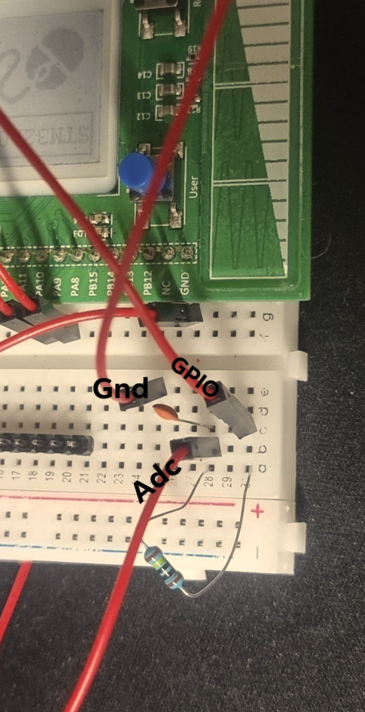

I'm trying to measure capacitance with my STM32L053-Disco
I'm using ADC and one output pin to charge the capacitor. I tried measuring time it takes for capacitor to charge to 62.3%.
The problem that I'm facing is that the values that I'm getting from ADC never show that it gets any charge.
I use 1 nF capacitor and 1MOhm resistor
 This is my circuit:

I never get to measuring capacitance because these are the ADC values that I get:
Can anybody help me?

I know that this is basic of electronics but I'm gonna ask anyway, I've looked up a lot of examples of people doing this capaciter meter and they are always measuring 3.3*0.623, the thing is when I plug in a big resistor I could never reach that value, it just stays at 0.144 and nothing ever changes..
JRubė.1
Also my ADC for some reason doesn't start from 0, it starts at about 0.05V, any ideas why that could be happening?
Offset.
You cannot expect to get exactly 0.000 V or 3.300 V from a GPIO.
Additionally, you might have some leakage current from the ADC input creating that voltage together with the 1M resistor.
LCE
Principal II
Start with checking your ADC function:
replace the capacitor with another 1M resistor, then depending on the GPIO setting, you should measure about 0V or 1/2 of VCC.
If that is not the case, your ADC control does not yet what it should.
OR the 1M might be too high for the ADC's input impedance. That's the case when GPIO is high and ADC voltage is sign. below 1/2 of VCC.
Better check with a multimeter, even your wiring could be wrong. Sure you're on the right IOs? :)
