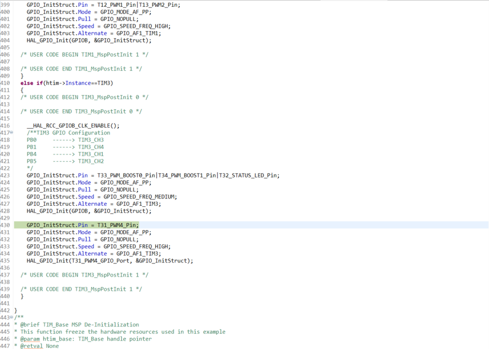

Hi all,
We have a product containing the STM32G030K8T6 MCU. The code is working like expected and the product is meeting all specifications. The product is battery powered and can be charged via USB. So far so good.
If the product is assembled it will go into a burn-in test where 70 plus products will be charged and de-charged between 3 to 10 times. During this test 1 to 3 products are failing, and with failing I mean the MCU just stops operation.
It stops at the following line of code:
We found a lot of high dV/dt on the powerline and think this is causing the MCU to hang although we cannot reproduce on a single piece.
If we test products randomly on bench or at our desk it doens't have any issues.
Currently we are at a dead end, does anybody has any suggestions?

‎2024-04-23 5:51 AM
In line 423, are you sure that pin named STATUS_LED_PIN should be in mode AF1_TIM3?
