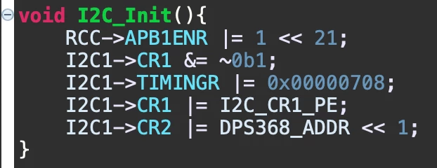

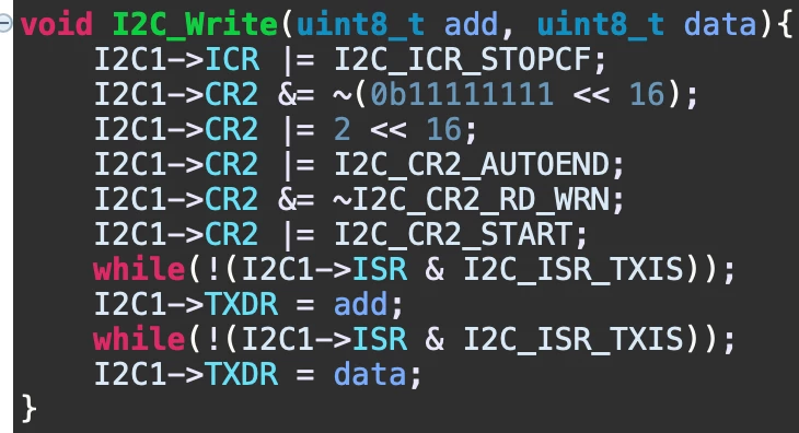

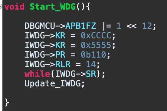

I have a situation where the configured watchdog on my STM32L031 does not trigger even though the MCU gets stuck in an I2C function. In my program flow, I first run through some initializations (as well as I2C_Init()) and then start the IWDG (Start_WDG()). I then try to establish an I2C connection to another device. In some cases this fails and I get stuck on line "while(!(I2C1->ISR & I2C_ISR_TXIS));". Surprisingly, in this situation the watchdog does not trigger as expected. I am of course aware that the code in this form is not properly programmed and error handling in this situation solves the problem (implemented a timeout which itself does a system reset). Nevertheless, it would be interesting to know why the IWDG in this version does not trigger.

Do you enable the clock LSI (disabled after reset) for the IWDG? The IWDG requires this clock source. Can be done in RCC->CSR register by enable bit LSION and wait until LSIRDY flag is set by hardware.

Don't see issues with your Start_IWDG() code, provided Update_IWDG does the right thing.
The first line will freeze IWDG when the debugger halts the MCU. Did you try without debugger attached? How did you then find out that the MCU "get stuck on line ..."

Yes LSI is enabled. When IWDG is enabled then, according to de reference manual, the LSI can't be disabled any more. So there shouldn't be a problem with that.

Please show your code for updating the Watchdog.
The "Update_IWDG" is a definition with "IWDG->KR = 0xAAAA".
When I analyze the whole thing with the debugger, I initially just let the program run. When I then press "pause," the program counter always points to the while loop.
If I try the whole thing without a debugger, the MCU also doesn't behave as expected. For example, it doesn't respond to a button press, which should trigger something else (the ISR is most likely executed correctly, but it has no effect because after the ISR, it jumps back to the while loop). If a reset were to be triggered by the IWDG, I would certainly detect it via the reset control bits.
So for me it's clear that the MCU gets stuck and the IWDG doesn't fire. I read somewhere that the I2C peripheral, when totally busy, could block the WDG. Could that really be?
But where do you do the Watchdog updates during the running program?

@Brigei  Hence the need to know how, exactly, you are refreshing the Watchdog.
In my main loop (not in some ISR which potentially get triggered) - which generally works fine and exactly like expected (WDG fires when i set the counter just not long enouth). When debugging (setting a breakpoint right after the while loop) i can see that the while loop doesn‘t exit any more.
