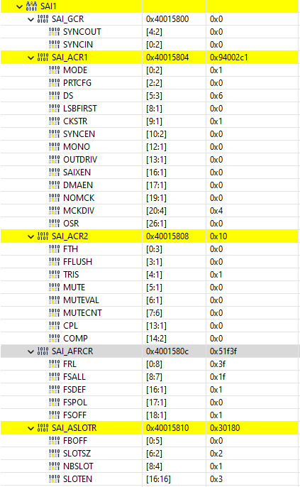

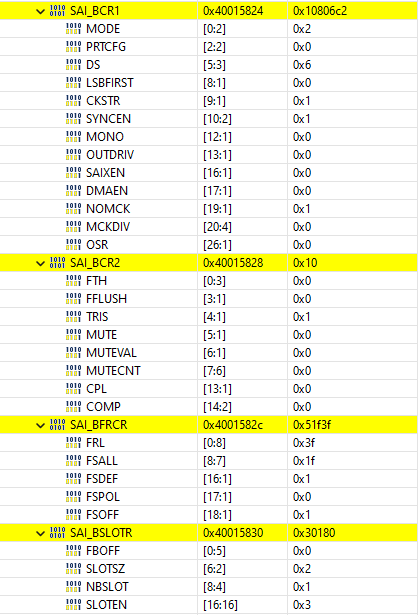

I am trying to get the SAI1 periperhal configured in I2S Standard mode going on the STM32H753ZI. During my testing sessions I found that my master clock is so far off it doesnt make sense.

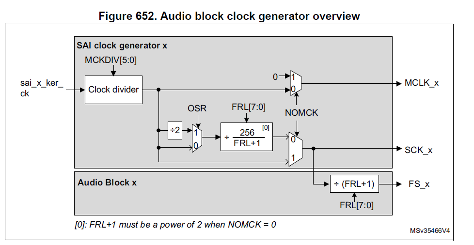

Based on the figure 652 within the TRM, it shows that the MCLK_x is produced by having NOMCK = 0 and just having the sai_x_ker_ck divided by MCKDIV,
_legacyfs_online_stmicro_images_0693W00000bhcaVQAQ.png in which case should have been 98.304MHz/4 = 24.576MHz, but somehow getting 5MHz???
Current Configuration:
  • Using SAI1 Block A is Master Rx and Block B is Slave Tx
  • SAI1 Block A is Async and Block B is Sync
  • Using the frequency of 96kHz
  • SAI1 A Clock Kernerl is rated at 98.306MHz
  • Using I2S Standard
  • Using PLL2_P_CLK to source SAI1 A MCLK
  • Over Sampling = 0 (*256)
Things I have done thus far:
  • Probbing SAI MCLK getting around 5-6 MHz
  • Confirmed that the PLL2_P_CLK is indeed 98.304MHz through MCO2
  • Checked wiring
  • Double checked pinout
Picture of register of both SAI1 Block A and B
SAI 1 Block A reg:
_legacyfs_online_stmicro_images_0693W00000bhcYyQAI.pngSAI 1 Block B Reg:
_legacyfs_online_stmicro_images_0693W00000bhcZIQAY.pngPicture of SAI 1 Block A MCLK

At first glance the register settings look correct.
Have you checked the other clocks? Do you get the 6.144 MHz for SCLK ?
Have you checked the GPIO for MCLK, concerning the correct alternate function ?

You should have, at fs = 96 kHz:
LRCK = word clock = sampling rate fs = 96 kHz
SCLK = bit clock = 64 * fs = 6.144 MHz
and then your "problem child":
MCLK = (OSR + 1) * fs = 24.576 MHz or 49.152 MHz

If not: what are the exact register settings at 96 kHz, the peripheral clock, what do the output clocks do ?
The problem has not been solve.
The register settings is listed in the original question. The periperhal clock is using PLL2_P_CLK.
The output clocks are just shown in accurate, as shown in the original question, MCLK is completly wrong and the FS clock is shown also as 25MHz
