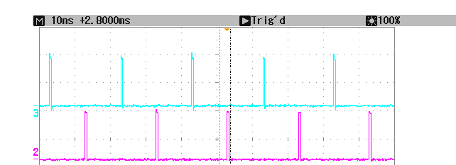

I have those pulses on PE11 and PE13
i want to make a logic gate actually a OR LOGIC GATE without using hardware and map the result for example in PE 14

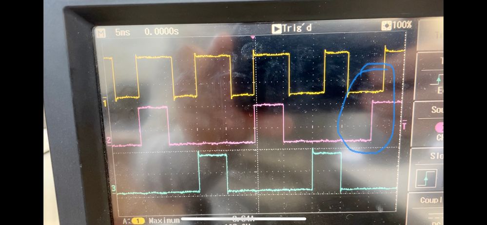

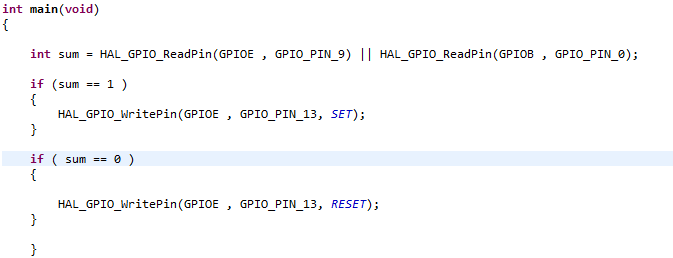

Sorry for not explaining well, my english is not very good but what i am trying to do is a sum of two signals. I have write a simple code . I have the violet signal in PE9 and the light blue signal in PB0. I am trying to do the sum of this pins and map it on PE13. Despite iam using a boolen library using (OR || symbols) ,it is not what i expected, because it is not a real sum, in blue color you can see that it is a fake sum. What can i change ? How can i do an accurate sum between pins?
Thank to everyone that will answer. Respect to anyone!0693W00000Npyq6QAB.jpg0693W00000NpyqGQAR.png
