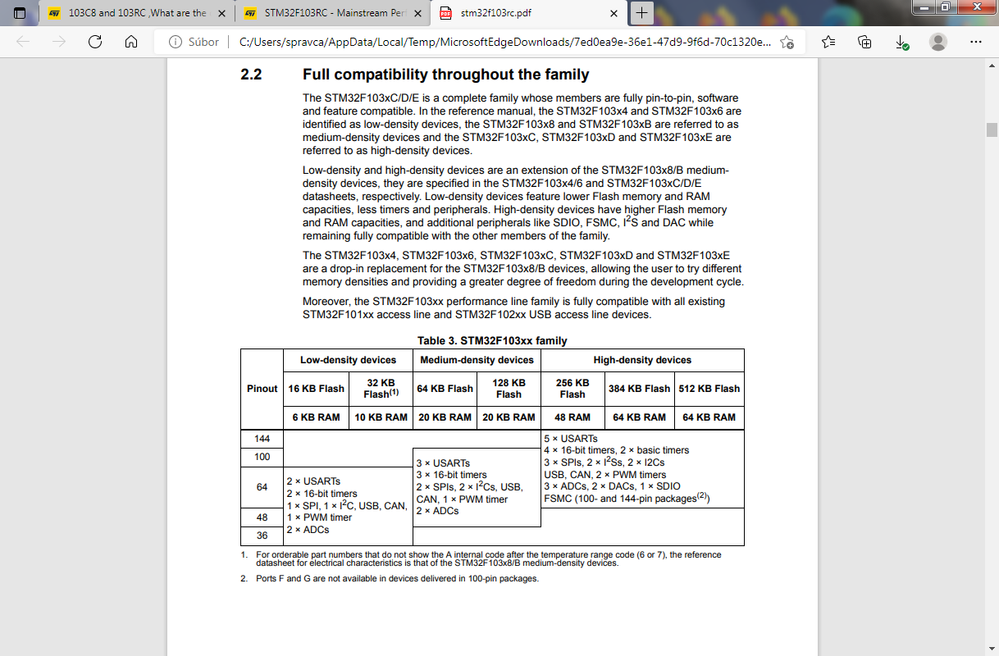

103C8 and 103RC ,What are the differences configuration between these two processors? I am configuring with register level. i search and i think all features are same. someone use it for same project?

What pins, R or C ??? Zero info in question.
