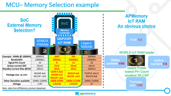

Alex - APMemory
Senior II
Few comments about PSRAM
APS512XXN is an Octal / Hexa RAM and is not supported on F7 / FMC memory controller, but would be most effective solution on SMT32H7,U5, H5, L5, L4+... for example. Key advantage of QSPI/OPI/HPI PSRAM versus legacy SDRAM are pin count, power, simplicity of design, space saving and especially for Hexa PSRAM versus SDRAMx32 competitiveness. Some illustrations at following links:  https://www.st.com/en/partner-products-and-services/iot-ram-opi-psram.html and https://www.st.com/en/partner-products-and-services/iot-ram-hpi-opi-psram.html
- You can see some comparison of SDRAM/ADMUX PSRAM (FMC Memory controller) and OPI/QSPI PSRAM (Octal memory controller)
Alex

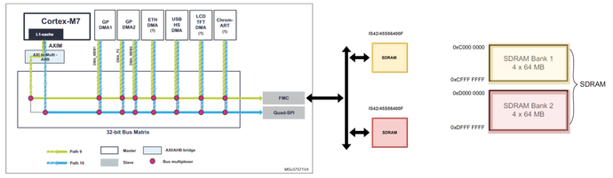

Dear @Alex - APMemory  & @FBL
Thank you immensely for your assistance. Due to your help, we've been able to modify our requirements to a maximum RAM of 72 MBytes.
The revised architecture is as follows:
As a controller we still stick to the STMF32F723 controller
We plan to use the IS42/45S86400F, which has an internal design featuring 16M x 8 x 4 banks. Unfortunately, my search for SDRAM chips did not yield any options with 128MByte or 256MByte capacities. Are any of you aware of SDRAM chips that offer these higher memory sizes? Utilizing a single chip with a higher capacity would significantly simplify both hardware and firmware development.
Best regards, Corsin Obrist

So the two RAM Chips can be accessed (written/readout) over the FMC bus?
Best regards
Corsin
