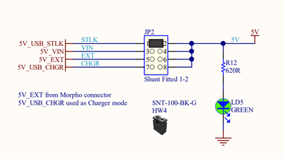

2. When I use External 3.3V the LED5 is turn-on. I don't understand why because we can see in the datasheet that only the 5V is connect to LED5:

>> I don't understand why because we can see in the datasheet that only the 5V is connect to LED2
Shows schematic section for LED5 (LD5) ....
You're right. My mistake. I meant LED5
I fixed it in the post. Thank you

And how the LED5 is turn-on?
Most LDO voltage regulators can be backpowered to some extent. It doesn't take much current for an LED to turn on, so that's probably why it's lighting up. Measure the voltage on the 5 V rail in such a situation, likely it's just below the 3.3 V rail.
