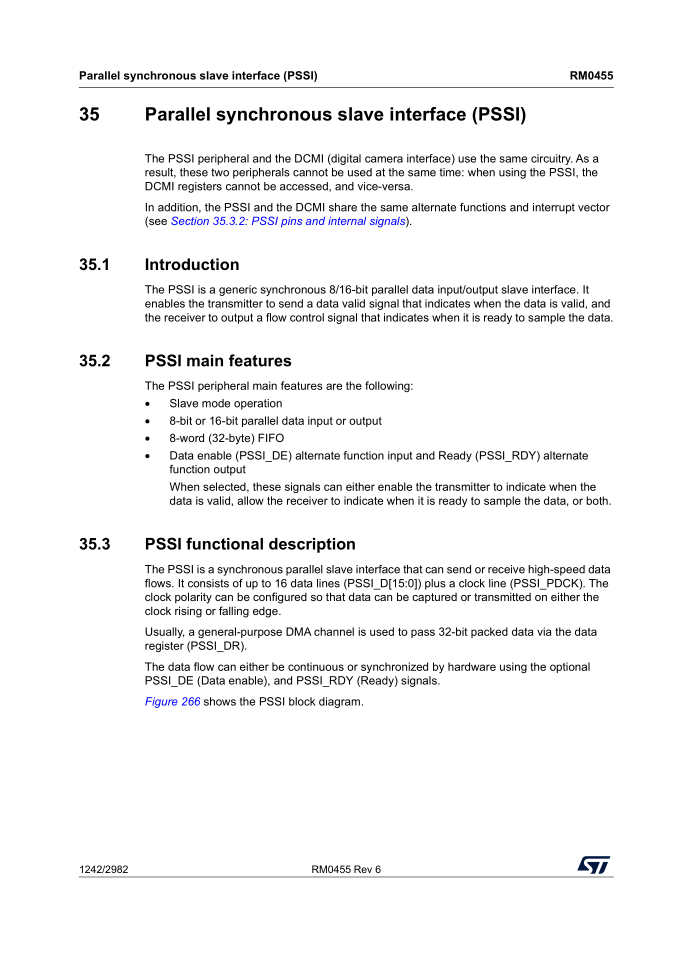

I personally would start experimenting with PSSI to provide buffer between DMA and the output.
Uwe Bonnes
Principal III
PSSI?
waclawek.jan
PSSI!
