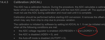

LDORDY bit does not exist in any registers mentioned in RM0503 rev 2 . I am using ADC1 in STM32U031R6T6 and the code migrated from STM32L010R8T6 is not working .

Thank you for reporting this issue. Can you give more precision about your request. For the LDORDY bit that is mentioned on the Calibration (ADCAL) part of the RM0503, but it is not mentioned in any register, I've escalated this internally for investigation and correction if necessary (under internal ticket number 186646).

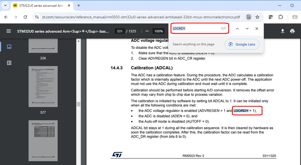

Not sure what you were asking for there, but this confirms that LDORDY appears once - and once only - as mentioned by @KSB :
So it is, indeed, referenced but never defined.

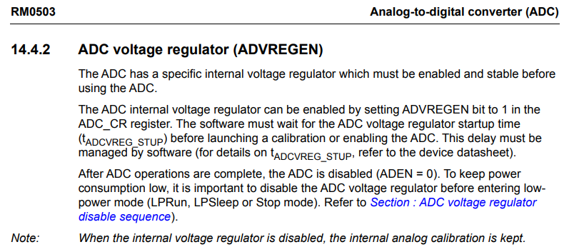

The description of the ADC voltage regulators makes no mention of there being any "ready" signal or flag available:
So is this "LDORDY=1" supposed to indicate the completion of this software delay?
