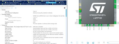

I am using stm32h750vbt6 for pmsm foc. I want to know if there is a way to use hrtim in center aligned mode as it would be needed for svpwm.
Right now I'm updating the duty cycle with the following settings.
Set comparator value: counter value/2 - duty/2
Reset comparator value: counter value/2 + duty/2
And I'm updating on timer update event.
Is there any suggestions or I'm doing it right?

The HRTIMER counters can operate in Up‐Down counting. This mode presents advantages for fixed switching frequency power converters. The HRTIM is natively designed with up-counters. It offers however an operating mode with up-down counters, also called center-aligned mode.
You can configure it by STM32CubeMx: "Up Down Mode",
Best regards.
I am using stm32h750vbt6, does this mcu has center aligned mode in hrtim because i dont see any option in stm32cubemx for it.
Yes indeed, this feature is available for STM32G4 chip which contains an Hrtim version different from the one in h7.
Best regards.
I am talking about stm32h7 here, So kindly tell me if the solution i provided for center align in stm32h7 will work for me?
Yes, this sounds correct, if the computation of SET/RESET events could be done fast enough regarding the PWM period.
Please, notice that enabling the preload of registers is a good practice, allowing the update to be taken in next update event and to ensure a coherency in registers values.
