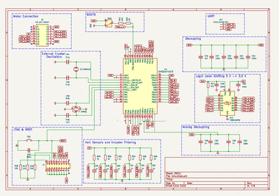

recently I made a board for a project and was planning to flash firmware  with ST-LINK/V2. However, when I wanted to flash a test program I got a message from Console:
Target no device found
Error in initializing ST-LINK device.
Reason: No device found on target.
I checked all the connections and VDD pins with decoupling caps and looks like everything is properly connected. Yet still I don't understand what is the reason of not connecting. Schematic of the project:

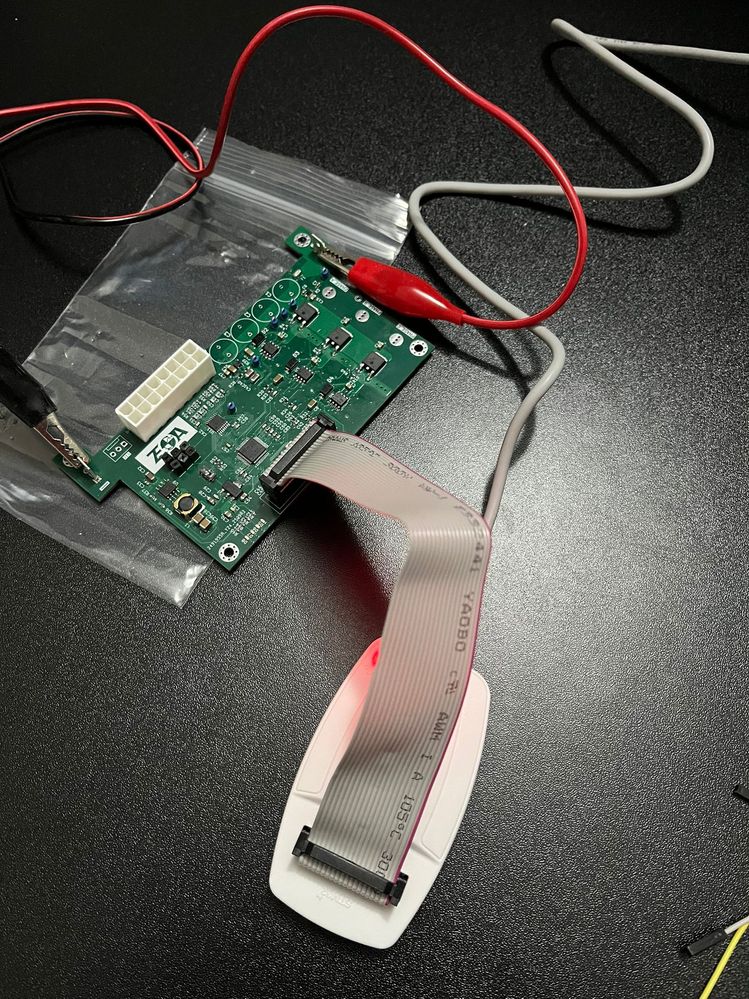

Physical connections:
I upgraded ST-LINK tool to the latest version and the MCU I am using is STM32G474CET3
ST-LINK/V2 model: B202533
Most of the design is just copied from the Reference design STM32G4 Series document.

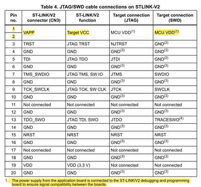

Pins 1 or 2 need to be connected to VDD in order for the level shifters to work. It is not optional.
Voltage needs to be reported correctly in STM32CubeProgrammer.

Primary SWD is short single wire debug, not 20 wires... but right connection require minimum info blocked on image. Is your V2 ISOL ?
richi

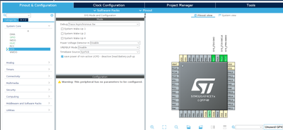

Okay providing +3V3 to pins 1 and 2 solved the problem. But just temporarily. I can flash the program but I am unable to see register content , Live Variables, Variables, literally everything is greyed out. This is my .ioc:
If you have a new problem, mark a solution here and ask it in a new thread. Provide a relevant screenshot. Nothing is grayed out in the screenshot you provided.
