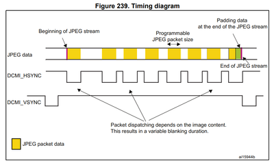

In your application note AN5020 and related to JPEG reception. i have some questions and hopefully you can answer them so every thing work.
Each JPEG stream is divided into packets, which have programmable size
What does JPEG Stream means? is it JPEG frame or what exactly?
What packets mean? Minimum Code Unit (MCU) or what?
also how many packet can be received between every HSYNC, one packet or more?
how this packets can have programmable size and which register responsible for this?

JPEG codec can decode a JPEG stream as defined in the ISO/IEC 10918-1 specification.
Once the JPEG header generated, the incoming MCUs are encoded, and the resulting data stream sent to the output FIFO. Number of MCUs to be encoded or decoded is configured in JPEG_CONFR2
This figure in the reference manual illustrates the dispatching of data. DCMI_HSYNC signal act like blanking signals.
I guess the JPEG header contains information about the image size, resolution, and other parameters. By parsing the header, you can determine the actual size of the image and allocate memory for the frame buffer accordingly...

That is not the problem. the problem is how to configure the DMA if we dont know the image size. in jpeg the image size is un known.
i dont want save it in file. i want to decode it and show it on display.
