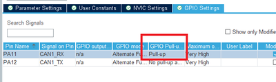

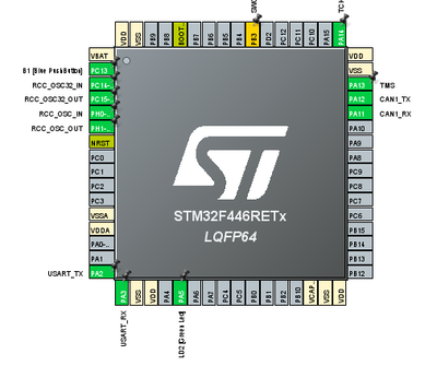

Hello, i am using f446re nucleo board and have been facing a problem for a while now. I need to establish a loopback CAN transmission and the debug mode allows me to find a bug in the CAN Start function: HAL_ERROR 0x1 returned everytime i attempt.
here is the while loop i am talking about:
while((hcan->Instance->MSR & CAN_MSR_INAK) != 0)
  if((HAL_GetTick() -tickstart) > CAN_TIMEOUT_VALUE)
    hcan->ErrorCode |= HAL_CAN_ERROR_TIMEOUT;
    hcan->State = HAL_CAN_STATE_ERROR;
    return HAL_ERROR;
Configure CAN_Rx pin (PA11) in pullup mode:

SofLit
Could you please share your code or your ioc file if you're using CubeMx?
Share the GPIO pin configurations.

Here is the GPIO config from the .ioc
I need your ioc file. please attach it.
PS: This is NOT an online support (https://ols.st.com) but a collaborative space. So please be polite in your reply. Otherwise, it will be reported as inappropriate and you will be permanently blacklisted from my help/support.
here is the file. Sorry i clicked on the Accept as Solution but did not wanted to. Missclick.
Erwan03
Thank you for your help. I don,t know how come this worked but it did.
