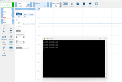

So , i am facing a problem to display the frame i am supposed to send from CAN_Tx pin in loopback mode. I am using picoscope to display.
Here is the function i wrote to configure the Header, and send the data:
void CAN_send(void)
char msg[50];
CAN_TxHeaderTypeDef TxHeader;
uint32_t TxMailbox;
uint8_t TxData[4] = {'T','E','S','T'};
TxHeader.DLC = 4; // 4 data byte
TxHeader.ExtId = 0; // Not used so far
TxHeader.IDE = CAN_ID_STD; // Standard ID
TxHeader.RTR = CAN_RTR_DATA; // Data and not remote frame
TxHeader.StdId = 0x103; // Data ID
TxHeader.TransmitGlobalTime = DISABLE;
if(HAL_CAN_AddTxMessage(&hcan1, &TxHeader, TxData, &TxMailbox)!=HAL_OK)
Error_Handler();
while( HAL_CAN_IsTxMessagePending(&hcan1, TxMailbox));
sprintf(msg, "Message transmitted\r\n");
HAL_UART_Transmit(&huart2, (uint8_t*)msg, strlen(msg), HAL_MAX_DELAY);
In the Main function, i am calling it after the HAL_CAN_Start function. The uart connexion tells me that the frame is sent but i can't see it though.
Thank you again for your precious help!

Erwan03
Nothing changed:
Let me inform you than i got it to work once but several weeks ago and when i added some structures and other functions in order to fit it into a real project then it couldn't work anymore. And the parameters you asked me to change were the same unfortunately.
Wait Wait! It works actually.
The debug mode does not allow us to see a frame. Only run mode. Thank you for your help!

Nice! You're welcome :smiling_face_with_smiling_eyes: .. But still strange it could not be running in debug mode!
Which Toolchain are you using? I will try it with a NUCLEO-F446RE board when I have one on hands.
