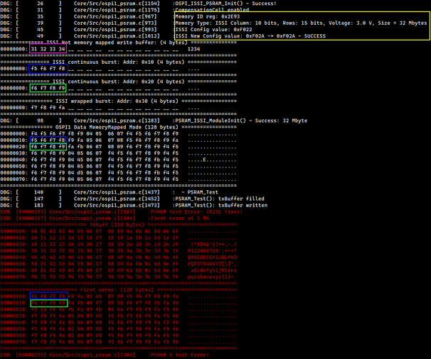

Hi All!
I try to use 2 pieces of IS66WVO32M8 PSRAM with multiplexed OSPI ( only the NSS pins not shared ) with STM32F585 in memory mapped mode.
Previously, I used 2 pieces of APMemory's APS12808L in memory mapped mode without any issues.
I reconfigured all the necessary parameters to IS66... according the datasheets (AN5050, STM32F585 OSPI errata), and other's suggestions in the forum, like:
https://community.st.com/t5/stm32-mcus-products/problem-with-psram-peripherals-of-stm32h735/m-p/706406#M257198
or
https://community.st.com/t5/stm32-mcus-products/problem-with-psram-peripherals-of-stm32h735/td-p/706406

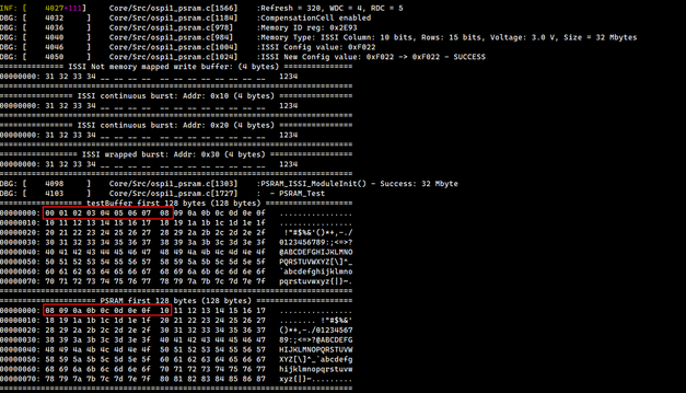

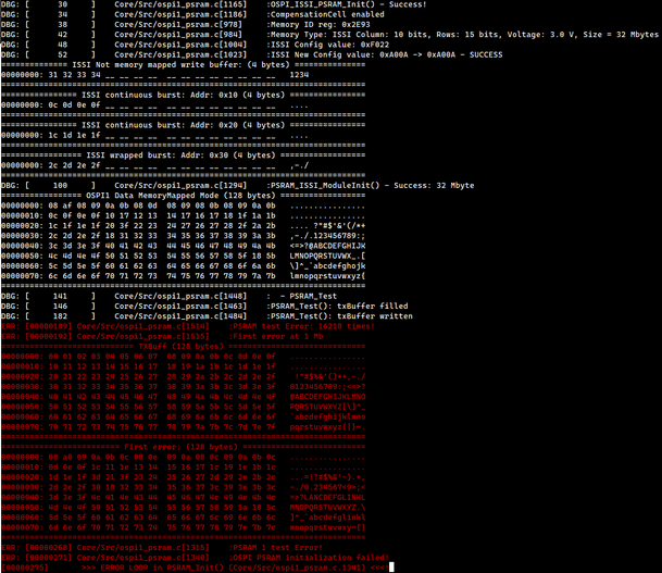

I can read the ID and configuration registers, I can also modify them (Yellow square), but when I write directly or indirectly to the memory area, and read back for verification, it causes an error.
I tried to change the OSPI speed, using 55, 80, 100 MHz (with recalculated refresh rate using 4us tCEM:  220, 320, 400, 640), with- or without delay block, DHQC enabled/disabled (I know the errata), and DQS values, etc., but didn't work, except that some settings were totally wrong for configuration registers.
I don't know exactly what the error is: writing to memory area or reading it.
My biggest success is that I can read the same data from the same address in both memory mapped mode and normal mode (blue and green squares), but this data is not the same as what I wrote (pink square).
There is someone who configured and use successfully this type of PSRAM ?
Maybe I missed something ?
There is My ISSI PSRAM related routines, please check it:

 * @brief Configure ISSI PSRAM
 * @PAram hospi OSPI handle
 * @return Size of the RAM in megabytes
uint16_t  Configure_ISSI(OSPI_HandleTypeDef *hospi)
    uint8_t regW_MR0[4]={0x31, 0x32, 0x33, 0x34};  // MR0 + MR1
    uint8_t regR_MR0[4]={0};
    uint16_t regVal = 0;
    uint16_t id = 0;
    uint32_t size = 0;
    // Read ID
    if (ISSI_ReadReg(hospi, ISSI_READ_CFG, 0x00000000, (uint8_t*)(&id), 2 ) == HAL_OK)
        Debug("Memory ID reg: 0x%04X\n", id);
        if ((id & 0x0F) == 0x03 ) // ISSI
            size = (1 << (((id >> 4) & 0x0F)+1)) * (1<<(((id >> 8) & 0x0F)+1)) ;
            Debug("Memory Type: ISSI Column: %d bits, Rows: %d bits, Voltage: %s V, Size = %d Mbytes \n",
              ((id >> 4) & 0x0F)+1,
              ((id >> 8) & 0x0F)+1,
              (id >> 13) == 1?"3.0":"1.8",
              size / 1024 / 1024
    // Read and modify configuration register
    if (ISSI_ReadReg( hospi, ISSI_READ_CFG, 0x00040000, (uint8_t*)( &regVal ), 2 ) == HAL_OK)
      /* ISSI configuration register
      default: 0xF022
      F0 = 1 111 000 0 : Noraml op, 24Ohm, Reserved, DQSM: 0
      22 = 0010 0 0 10 : Latency: 5Clock, Variable, 32 burst len
      1111000000100010
      1111000000001010
        Debug("ISSI Config value: 0x%04X\n",regVal);
        regVal |=  (1<<3); // Fix latency
//        regVal &=  ~(0x70); // Latancy code: 3 cycle
        // Check the write was success
        if (ISSI_WriteReg( hospi, ISSI_WRITE_CFG, 0x00040000, (uint8_t*)( &regVal), 2 ) == HAL_OK)
            uint16_t newRegVal = 0;
            ISSI_ReadReg( hospi, ISSI_READ_CFG, 0x00040000, (uint8_t*)( &newRegVal), 2 );
            Debug("ISSI New Config value: 0x%04X -> 0x%04X - %s\n",
                  regVal, newRegVal, newRegVal == regVal?"SUCCESS":"FAIL");
        else
            ERROR("ISSI reRead Configuration Error!\n");
    else
        ERROR("ISSI Read Configuration Error!\n");
    // Read preamble register value
    if (ISSI_ReadReg(hospi, ISSI_READ_PATTERN, 0x00000001, (uint8_t*)( &regVal), 2 ) == HAL_OK)
        Debug("ISSI Preamble Pattern: 0x%04X \n", regVal);
    else
        ERROR("ISSI Read Preamble Error!\n");
    hexdump("ISSI Not memory mapped write buffer:",regW_MR0,4);
    //  Test conventioanl (direct) SPI transfer to memory
    if (ISSI_WriteReg(  hospi, ISSI_WRITE_COMMAND, 0x00000010, regW_MR0, 4  ) == HAL_OK)
        if (ISSI_ReadReg( hospi, ISSI_READ_COMMAND, 0x00000010, regR_MR0, 4 ) == HAL_OK)
            hexdump("ISSI continuous burst: Addr: 0x10",regR_MR0,4);
    if (ISSI_WriteReg(  hospi, ISSI_WRITE_COMMAND, 0x00000020, regW_MR0, 4  ) == HAL_OK)
        if (ISSI_ReadReg( hospi, ISSI_READ_COMMAND, 0x00000020, regR_MR0, 4 ) == HAL_OK)
            hexdump("ISSI continuous burst: Addr: 0x20",regR_MR0,4);
    if (ISSI_WriteReg(  hospi, 0x0000, 0x00000030, regW_MR0, 4  ) == HAL_OK)
        if (ISSI_ReadReg( hospi, 0x8000, 0x00000030, regR_MR0, 4 ) == HAL_OK)
            hexdump("ISSI wrapped burst: Addr: 0x30",regR_MR0,4);
    return size / 1024 / 1024;

    OSPI_RegularCmdTypeDef sCommand = {0};
    /* Enable Compensation cell */
    EnableCompensationCell();
    Debug("CompensationCell enabled\n");
    if (hospi->Init.DelayBlockBypass  == HAL_OSPI_DELAY_BLOCK_USED)
        LL_DLYB_CfgTypeDef dlyb_cfg, dlyb_cfg_test;
        // Delay block configuration
        if (HAL_OSPI_DLYB_GetClockPeriod(hospi,&dlyb_cfg) != HAL_OK)
            Debug("%s() - HAL_OSPI_DLYB_GetClockPeriod Error!\n",__FUNCTION__);
            Error_Handler() ;
        dlyb_cfg.Units = 0;
        // when DTR, PhaseSel is divided by 4 (emperic value)
        dlyb_cfg.PhaseSel /= 4;
        // save the present configuration for check
        dlyb_cfg_test = dlyb_cfg;
        // set delay block configuration
        HAL_OSPI_DLYB_SetConfig(hospi,&dlyb_cfg);
        // check the set value
        HAL_OSPI_DLYB_GetConfig(hospi,&dlyb_cfg);
        if ((dlyb_cfg.PhaseSel != dlyb_cfg_test.PhaseSel) || (dlyb_cfg.Units != dlyb_cfg_test.Units))
            Debug("%s() - HAL_OSPI_DLYB_GetConfig Error!\n",__FUNCTION__);
            return false ;
    // Configure_APMemory(hospi);
    uint16_t ramSize = Configure_ISSI(hospi);
    // Configure Memory Mapped mode
    if (hospi->Instance == OCTOSPI1)
        sCommand.FlashId            = HAL_OSPI_FLASH_ID_1;
    else if (hospi->Instance == OCTOSPI2)
        sCommand.FlashId            = HAL_OSPI_FLASH_ID_2;
    // Configure Write command
    sCommand.OperationType      = HAL_OSPI_OPTYPE_WRITE_CFG;
    sCommand.Instruction        = ISSI_WRITE_COMMAND;//APS6408_WRITE_CMD;
    sCommand.DummyCycles        = ISSI_WRITE_DUMMY_CYCLES;//DUMMY_CLOCK_CYCLES_WRITE;
    sCommand.InstructionMode    = HAL_OSPI_INSTRUCTION_8_LINES;
    sCommand.InstructionSize    = HAL_OSPI_INSTRUCTION_16_BITS;
    sCommand.InstructionDtrMode = HAL_OSPI_INSTRUCTION_DTR_DISABLE;
    sCommand.AddressMode        = HAL_OSPI_ADDRESS_8_LINES;
    sCommand.AddressSize        = HAL_OSPI_ADDRESS_32_BITS;
    sCommand.AddressDtrMode     = HAL_OSPI_ADDRESS_DTR_DISABLE;
    sCommand.AlternateBytesMode = HAL_OSPI_ALTERNATE_BYTES_NONE;
    sCommand.DataMode           = HAL_OSPI_DATA_8_LINES;
    sCommand.DataDtrMode        = HAL_OSPI_ADDRESS_DTR_DISABLE;
    sCommand.DQSMode            = HAL_OSPI_DQS_ENABLE;
    sCommand.SIOOMode           = HAL_OSPI_SIOO_INST_EVERY_CMD;
    if (HAL_OSPI_Command(hospi, &sCommand, HAL_OSPI_TIMEOUT_DEFAULT_VALUE) != HAL_OK)
        ERROR("Configure Write Command Error! \n");
        OSPI_Error();
        return false;
    // Configure read command
    sCommand.OperationType      = HAL_OSPI_OPTYPE_READ_CFG;
    sCommand.Instruction        = ISSI_READ_COMMAND; //APS6408_READ_CMD;
    sCommand.DummyCycles        = ISSI_READ_DUMMY_CYCLES;
        ERROR("Configure Read Command Error !\n");
        OSPI_Error();
        return false;
    // Enable memory mapped mode
    sMemMappedCfg.TimeOutActivation = HAL_OSPI_TIMEOUT_COUNTER_ENABLE;
    sMemMappedCfg.TimeOutPeriod     = 0xA0;//34;
    if (HAL_OSPI_MemoryMapped(hospi, &sMemMappedCfg) != HAL_OK)
        ERROR("Configure Memory mapped mode Error !\n");
        OSPI_Error();
        return false;
    Debug("%s() - Success: %d Mbyte \n",__FUNCTION__, ramSize);
    return true;
 * @brief PSRAM Initialization
void PSRAM_Init()
    bool ret = true;
    Debug("=== PSRAM 1 INIT ===\n");
    OSPI_ISSI_PSRAM_Init(&hospi1_psram, OCTOSPI1);
    if (PSRAM_ISSI_ModuleInit( &hospi1_psram ) == true)
        hexdump("OSPI1 Data MemoryMapped Mode",(uint8_t*)OCTOSPI1_BASE, 128 );
        if (PSRAM_Test( OCTOSPI1_BASE ) == true){
            Debug("PSRAM 1 test Success!\n");
        } else {
            ERROR("PSRAM 1 test Error!\n");
            ret = false;
    else
    ret = false;
    if (ret == false){
        ERROR("OSPI PSRAM initialization failed!\n");
        Error_Handler();
Thank You!

Hi @KDJEM.1 !
Thanks for the answer,
The ICache was always enabled on my fw. I also used DCache in Wrap and Incremental modes, but nothing changed...
I used only ICache With APMemory  and it worked perfectly.
Thank You!
Krisztian

Hello @KDJEM.1
I somehow missed Your question.
I checked again the datasheet of PSRAM, and yes, I only used dummy cycles for read, but it need to writings.
According to the datasheet I'm using 10-10 cycles, and the result is a little closer to My expectations, but not perfect.
In memory mapped mode some data was almost good but not in the right address.
I tried to change the dummy cycles, and refresh time but this was the best result.
About the DCache, You are right, I disabled it last time for a test.
Now, It enabled again in incremental mode
Thank You.

ccuebler
Hi @KDJEM.1
An addition information:
Now, the direct read / write is good with weird values:
   refresh = 320, Write dummy cycle: 4, read dummy cycle: 5
I tried five times with 1024 bytes long buffer, in a different address.
Because it was good, I ran the delay block tuner  (https://github.com/STMicroelectronics/STM32CubeU5/tree/main/Projects/B-U585I-IOT02A/Examples/DLYB/DLYB_OSPI_PSRAM_ExhaustiveTuning)
and I use that values :
dlyb_cfg.PhaseSel = 1;
dlyb_cfg.Units = 50;
I test it, but in memory mapped mode not works properly.
More interesting: The readed data shifted by 8 bytes...
I tried with or without DCache.
Have You any idea?
Thank You
Krisztian

Hi @KDJEM.1
Thank You, but as I mentioned, I ran this "delay block tuner / calibrator".
Finally, we replaced the ISSI to APS25608N (and configure it), and it works, but need to modify the whole product because of the 1.8V power supply.
So, if You or others in ST know the solution, please let me know.
