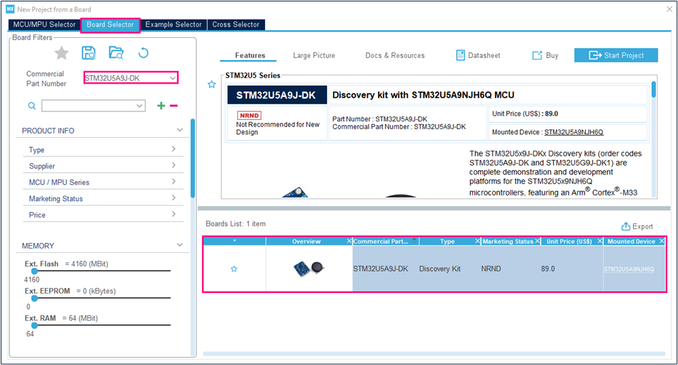

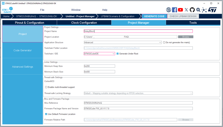

1. Open STM32CubeMX
2. Create a new project using the STM32U5A9J-DK board

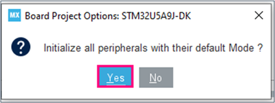

3. Initialize all peripherals with their default Mode?
Click [Yes].

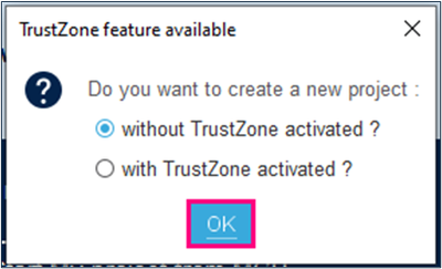

4. Do you want to create a new project?
Click [without TrustZone activated] and then click [OK].

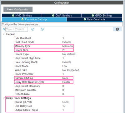

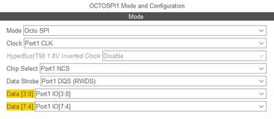

5. OCTOSPI1 Mode and configuration
For more details about this step, users can refer to section 7.2.4 "OCTOSPI Configuration and Parameter Settings" of AN5050 or this FAQ and memory datasheet.
6. Generate code

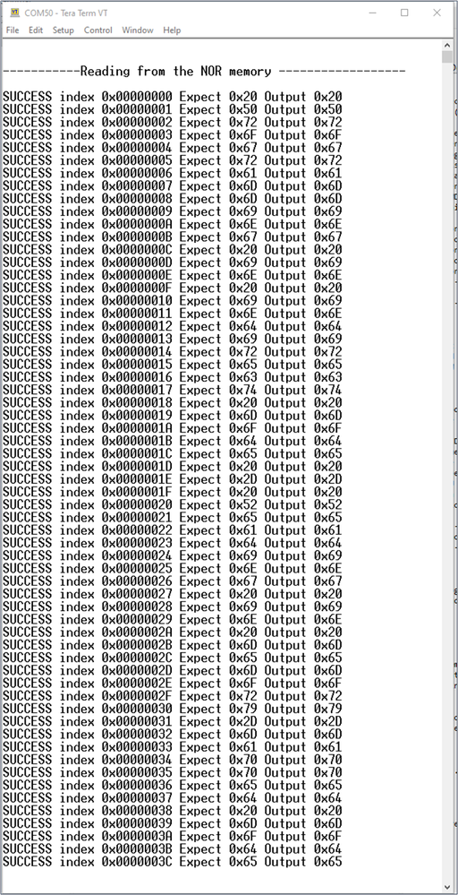

 EnableMemMapped();
 printf("\r\n\r\n-----------Reading from the NOR memory ------------------\r\n");
 for(index = 0; index < BUFFERSIZE; index++)
	 /* Reading back the written aTxBuffer in memory-mapped mode */
	 aRxBuffer[index] = *nor_memaddr;
	 if(aRxBuffer[index] != aTxBuffer[index])
		 printf("\r\nFAILURE index 0x%08X Expect 0x%X Output 0x%X", index, aTxBuffer[index], aRxBuffer[index]);
	 } else {
		 printf("\r\nSUCCESS index 0x%08X Expect 0x%X Output 0x%X", index, aTxBuffer[index], aRxBuffer[index]);
	 nor_memaddr++;

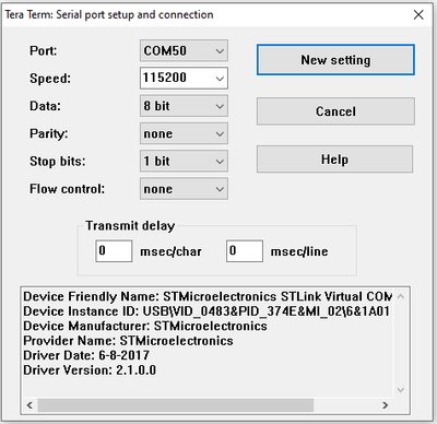

  • Open a console emulator such as Tera Term. Configure the console baud rate. The COM port name may differ on your PC.
  •  Tera Term displays that the results are successful.
After following this guide, you should now be able to calibrate the delay block. If you encounter any issues, we suggest that you create a post in the ST community for further assistance.
