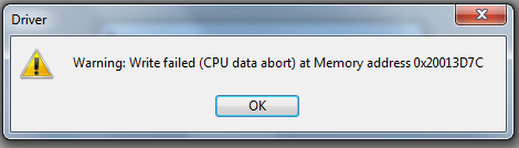

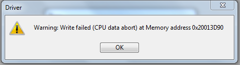

Posted on April 20, 2018 at 10:44
I followed your instruction and managed a successful IAP test with STM32F429 using support given in
.\STM32Cube_FW_F4_V1.21.0\Projects\STM324x9I_EVAL\Applications\IAP
However, I get error (attached as images)  while doing same test with STM32F103C8 using support given in
.\STM32Cube_FW_F1_V1.6.0\Projects\STM3210E_EVAL\Applications\IAP
Sir I have STM32F103 on board therefore I need it.
