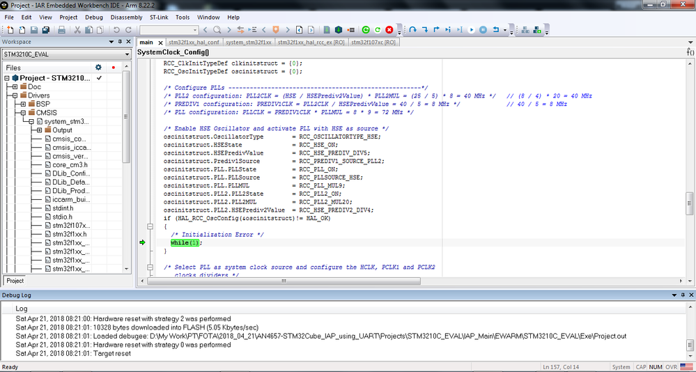

Ahmed.Waqar
Posted on April 21, 2018 at 10:37
Thanks Sir
Turvey.Clive.002
. Now I am using STM32F103RE that has 64k ram. But when I configure its clock, debugger gets struct in while loop at
if (HAL_RCC_OscConfig(&oscinitstruct)!= HAL_OK)
/* Initialization Error */
while(1);

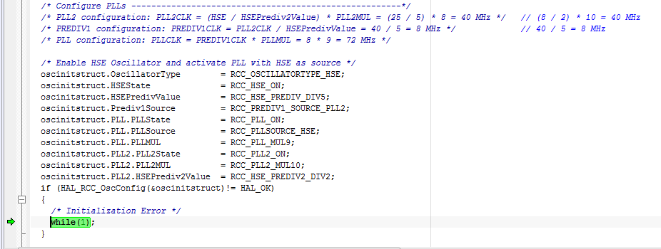

Please check the following modification for 8 MHz HSE. Am I doing it wrong?
I am using following IAP example
.\AN4657-STM32Cube_IAP_using_UART\Projects\STM3210C_EVAL\IAP_Main\EWARM\STM3210C_EVAL\
Posted on April 21, 2018 at 10:46
Even it is getting struct with following configuration as well
