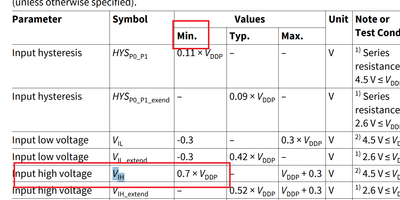

Indeed, based on TLE9879 datasheet, VIH min = 0.7*VDDP = 0.7*5V = 3.5V > VDD MCU:
So the levels of STM32 output high level is not seen as high level from TLE9879.

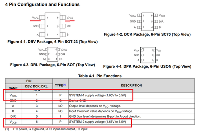

Indeed you need to implement level shifting circuit. There are many methods to implement that by hardware either by transistors or by a dedicated circuit level shifter, example TXS0108E IC. Watch this video.
I can also suggest 74LVC1T45:
