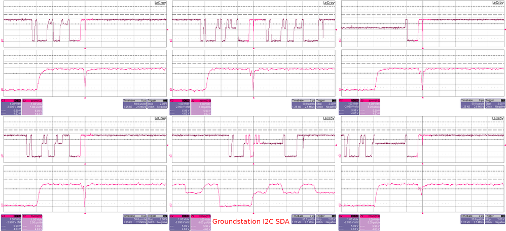

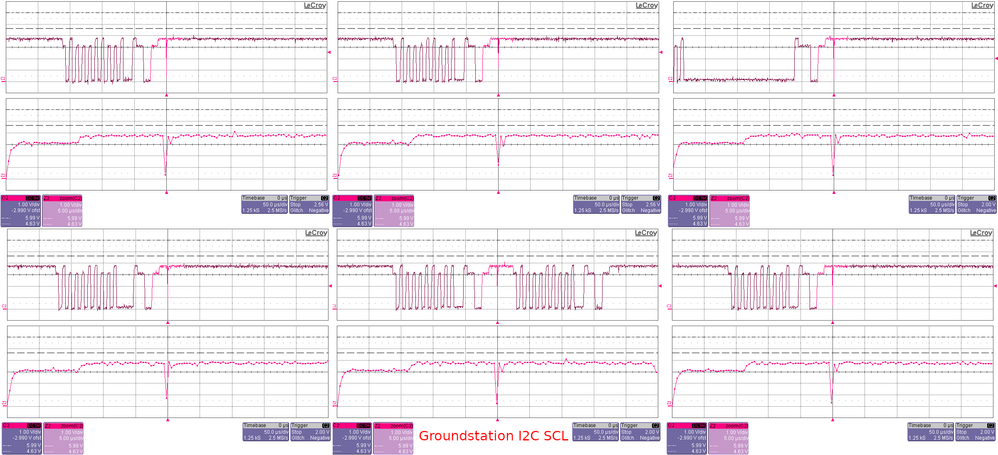

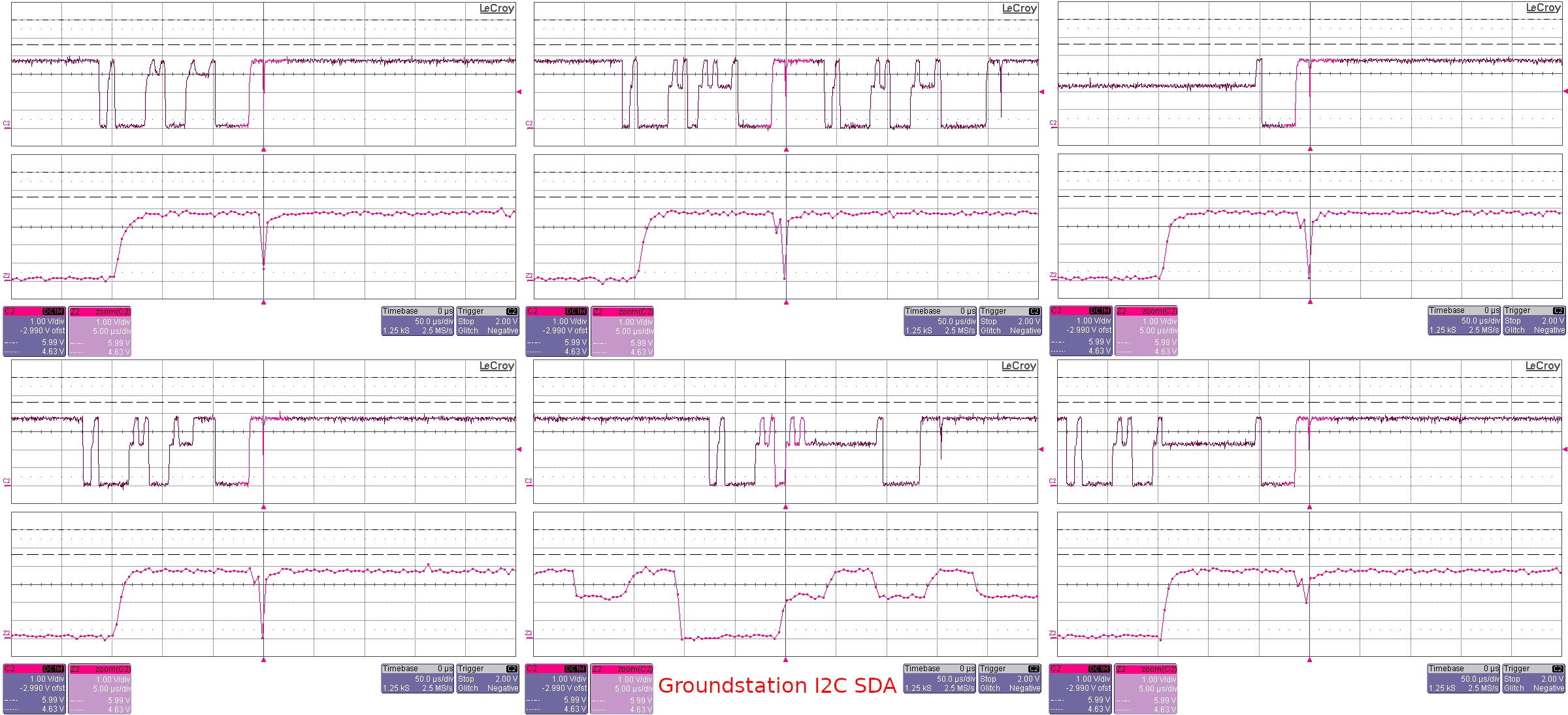

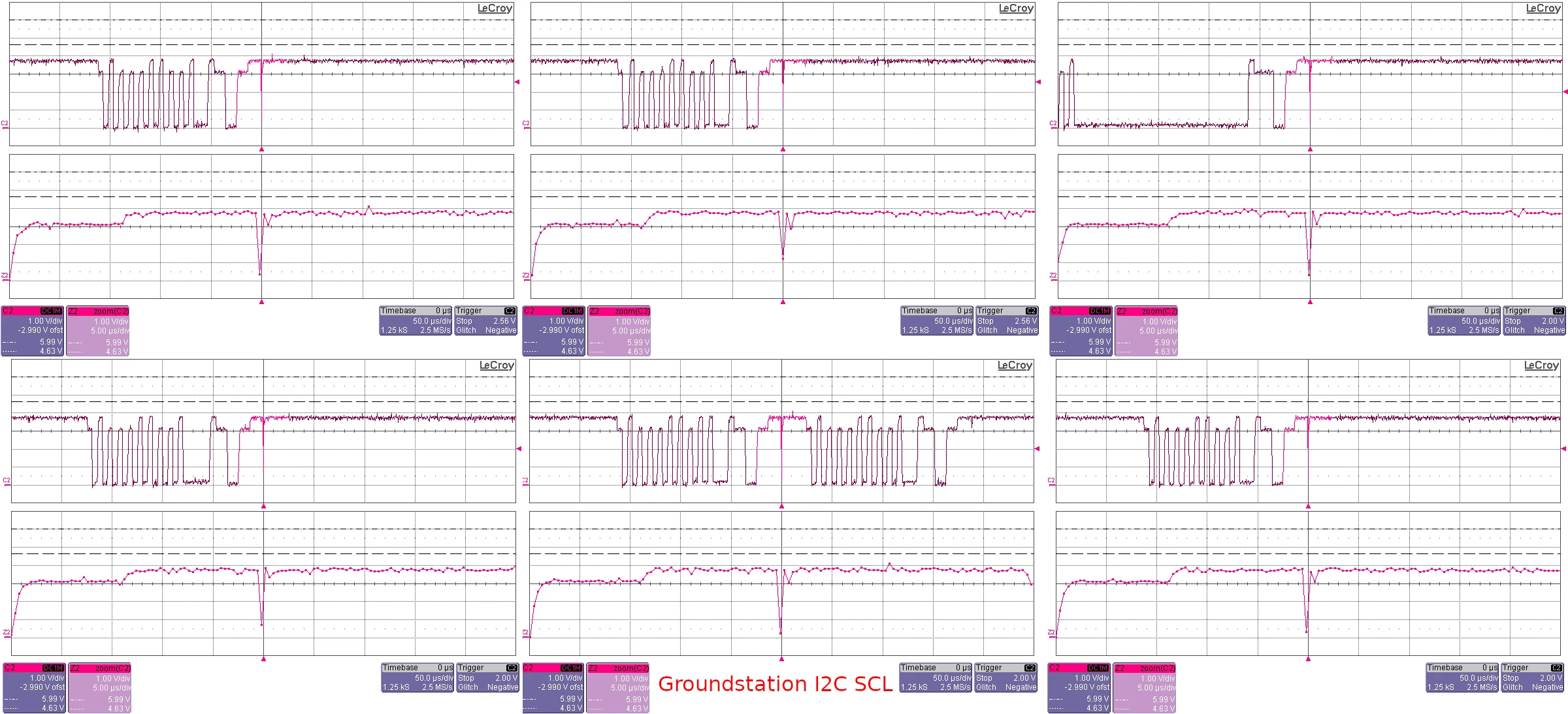

We are running the I2C on the 3.3V supplies. On A and B side is one or two MCUs connected. Pullups on SDA lines are 3.3kOhm. On the second look, it seems that the logic levels are indeed in the specified range. While sniffing the I2C comms I took notice of a 1us negative pulse after each message on the bus. This pulse can be seen on the SDA and SCL line. I believe this is what makes the communications unstable. See the attached plot of the SDA lines. I guess this isn't an issue of the STM MCU. Anyone has ever seen this?
Pics of the 6 separate measurements, including a zoom-in on the 1us pulse:

Hi. The spike does look to be strange.
1) Do you see this spike if the isolator is removed off the PCB?
2) Do you have the local despike caps as per the datasheet recommendation and close to the isolator?
3) We use Silabs isolators in high volume with zero issues. Also have used isolators from TI & NVE without issues. However, never used for I2C isolation.
4) From a quick review, you are using the 8 pin SOIC version of this I2C isolator? If yes, it appears that the TI I2C isolator p/n ISO1541 should be a drop in replacement. The TI version is recommending for a pull-up even on the SCL line. Perhaps you can perform a quick swap and try again.
http://www.ti.com/product/ISO1541
Very interested to hear about your results. Please update this thread as you continue to debug.

1) It seems the glitch is not coming from the before mentioned STM32F0 or isolator, but from a STM32F405VGT6 (master device). I'm a bit confused, except from a simple T-filter nothing else is installed on the I2C lines and the glitch is clearly related to sending an I2C message. I must have a look at the code now, but as far as I'm concerned this shouldn't happen with a properly initialized I2C interface.
2) Despike caps are there.
4) I do have the ISO 1541 in-house for later evaluation.

To close this topic, quick summary over found issues:
We are using clock stretching for I2C communications which gave us timing problems when the slave device was supposed to acknowledge a message. We therefore switched to a two channel bidirectional (Si8602 is one channel bidirectional, one unidirectional) isolator and the error rate has decreased to practically zero.
ABraun
ABraunAuthor
October 10, 2019
The seen spikes are artefacts of this failed clock stretching, where the I2C peripherie reinitializes.
