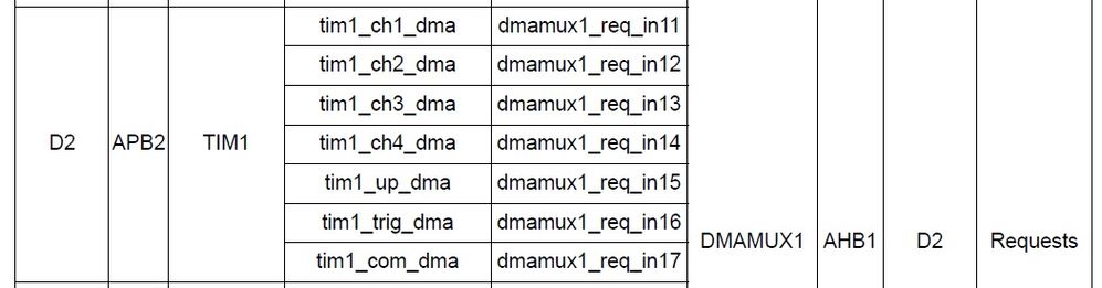

Wouldn't you just pick a trigger source in the DMAMUX? Like the TIM1 Update? As a DMA request # 15. Not tried this with the GPIO, but that's the sense of how the plumbing/connectivity gets done. On a phase of the TIM, then via a CHx / CCRx == CNT match.
0693W000006HdiAQAS.jpgYou might need to be sensitive to which bus the GPIO hardware is on, picking a DMA unit that deals with that properly, per the bus matrix diagram.
