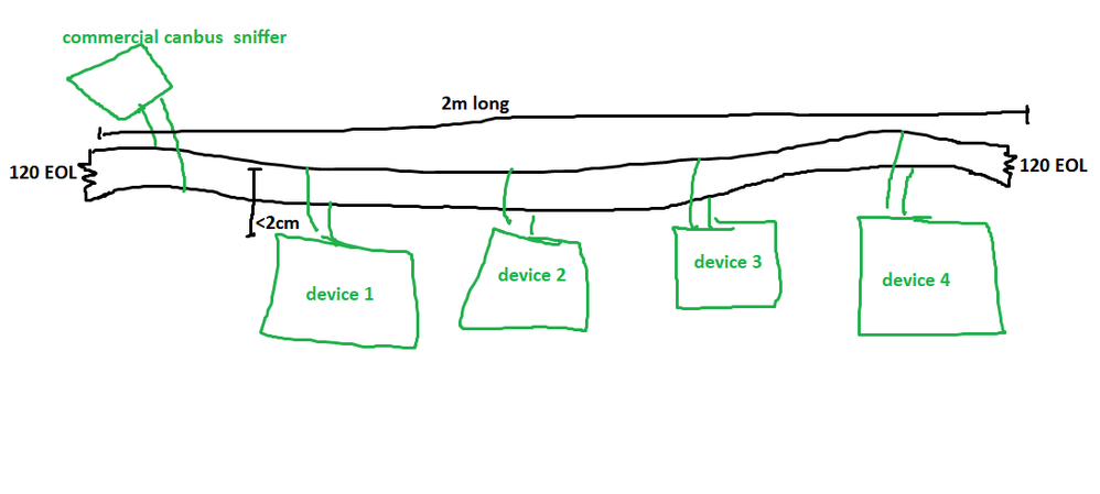

My setup consists in 4 identical nodes hooked up to a 2m long canbus.
- I can boot and talk with the canbus bootloader only when a single node is powered on in the bus.(the device enters its bootloader mode and waits for the 0x79 canbus command)
- Noone else in the bus is TXing anything only listening,
- BUT ....when more than one node is powered on ... the single node i want to boot doesnt reply to the 0x79 command (and i know is listening because as soon as i power off the rest of nodes and i send 0x79 trough canbus i get a reply from its bootloader)
- Extra weird thing this only happens with the initial 0x79 command, if i power on the rest of the nodes AFTER this 0x79 negotiation is done i am able to continue talking with the bootloader.

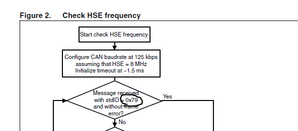

I found this note in the AN3154 appnote
I dont use more than one node at a time....

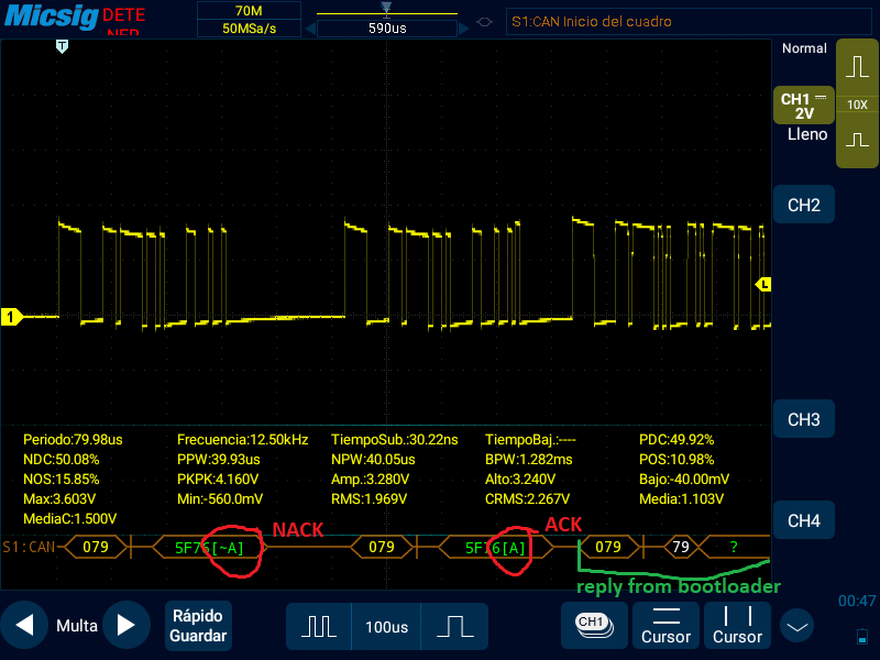

I just found another person with my same bug two years ago.
And while sniffing the bus i think i figured it out, for some silly reason the bootloader is expecting the first 0x79 command to be NACKED and only after that reply to the next 0x79 command.
If you send the 0x79 only once (automatic resend disable) the bootloader doesnt work either
