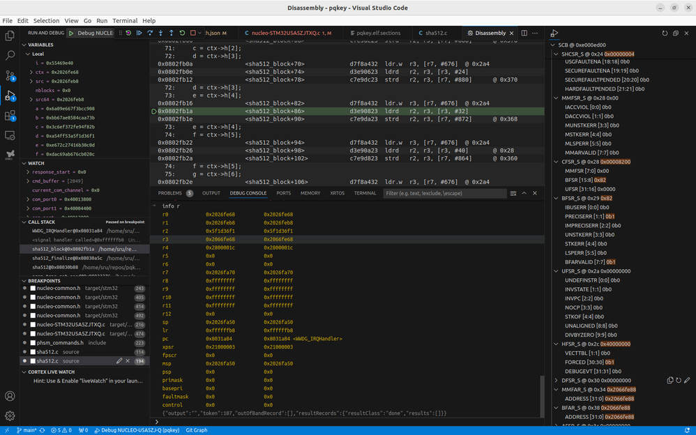

what is the cause of this hardfault ?
I execute my program on unmodified nucleo-u5a5zj-q , it reliably reach the "Default_Handler" from the default startup_STM32U5A5ZJTXQ.s.
My understanding from the screenshot:
  1. It goes here because a hardfault occurs:
    1. SHCSR_S.HARDFAULTACT = 1
    2. HFSR_S.FORCED = 1 --> not sure about the meaning of that one
  2. This hardfault is a "bus error":
    1. BFSR_S.PRECISERR=1
    2. BFSR_S.BFARVALID=1
    3. MMFSR_S = 0
    4. UFSR_S = 0
  3. The faulty instruction is execution from flash (ldrd at 0x0802fb1a): info from CALL STACK view
  4. The "bus error" is therefore caused by a 64 bit read at 0x2066fe88:
    1. BFAR_S = 0x2066fe88
  5. 0x2066fe88 is in the Main RAM, well inside the current stack, so the hard fault should not occur
One or more points above may be wrong since the conclusion makes no sense

LDRD/STRD are sensitive to alignment issues for the pointers
If a random interrupt, perhaps check source via NVIC
Check VCAP voltage and capacitors, these can cause sensitivity and failure issues. Certainly seen FLASH issues with insufficient bulk capacitance.
https://github.com/cturvey/RandomNinjaChef/blob/main/KeilHardFault.c

The address of the faulty address seems well aligned isn't it ?
  • base register is r3, which is aligned mod 8: 0x2066fe68
  • offset is 32, so final address (0x2066fe88) is also aligned mod 8
I believe that if the fault was due to an interrupt, the fault status registers would point to the interrupt code. Anyway my code do not have interrupt so I disabled them by setting PRIMASK=1, the same hardfault still occurs.
The STM32_Programmer_CLI tool indicates 3.29V, that seems well within the specs (I use brand new, unmodified nucleo board). I searched for "VCAP" in the nucleo doc but did not find it. Is there anything else I could check ?
