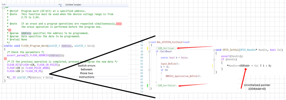

I was using the flash to save the configuration data of my mcu. But I've got two problems:
The HAL_FLASHEx_Erase function fails with a sequence error.
The first 4 bytes get zeroed with HAL_FLASH_Program. The mcu never boots up after that since the first 4 bytes are the stack pointer.
I checked all the parameters and they are all correct. After disabling the interrupts, the function works. While with a high frequency interrupt, the function always fails.
However, I never found anything about this in the reference manual as well as the errata. The reference manual says the processor will be paused and the read requests will be processed correctly after the operation is done.
Chip is STM32F401RC.
Below is my flash layout:
|Sect 0-1| 2 | 3 | 4 - |
|Bootldr | Cfg1 | Cfg2 | Program code|
The erased and programed data is in sector 2. And the code that starts the flash operation is in the last block.
wtywtykk
We found out the problem finally. It's caused by an uninitialized pointer and a race condition.
We have an led toggling in the systick callback to monitor whether the code in it completes on time. And we used a custom gpio library that accesses gpio with bitband address. However, i forgot to check whether the bitband pointer is initialized. An uninitialized pointer points to 0 address, so the first 4 bytes in the flash gets erased.

Review what's actually being erased.
If you erase memory used by the vector table things will break.
Your description suggests you're erasing different memory than you think you are.
More likely to be a coding issue than an errata.
waclawek.jan
What do those interrupts do? If you disable them selectively, is there any pattern with regard to FLASH programming?
Do you use some watchdog?

Thanks for coming back with the solution and explanation.
Please select your post as Best, so that this thread is marked as solved.
