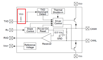

i've had the same issue. Set the internal pull-up on Rx pin and pull-down on Tx pin.
It's comprehensible but it should be a pull-up and not a pull down resistor. May be to handle the transients and to ensure the node are asserting recessive state if the pin is not yet initialized.
But you need to check if the transceiver has that pull-up on Tx internally:
Ex, MCP2551:
So if the transceiver has that resistor, you don't have to activate the resistor from the MCU side.

@kam8711 : You should not enable pull-down on Tx pin.
why?
In loopback mode, Tx and Rx are internally connected by hardware. If you enable the pull-up on Rx and the pull-down on Tx, a voltage divider will be formed on Tx/Rx path by the pull-up/pull-down resistors which should be avoided.
Please keep only the pull-up resistor on CAN_Rx pin.

The question is: is there any reason to enable the pull up/down resistor on Tx pin?
Many people do it so that is why im wondering….
Ex, MCP2551:
