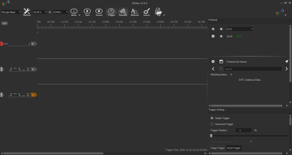

Hi all,I want to use the I2C of my STM32F100xx Low/Medium density value line Discovery board but without using STM32cube IDE because i want to learn the basic register initialization and each step necessary so that i can port it to any IDE but i am unable to get anything from my SCl and SDA pin.Here the code that i develop using IAR EWARM With the help of CD00246267.Point to note before this i interface GPIO as well as USART without any problem but in I2C didn't get any success.Here i am using PCF8574T as slave.Please help ..

 Note: I have checked the output with a logic analyzer its only displaying logic high.0693W000006G1f6QAC.png

I'm not sure what's going on with your interrupt stuff (the "IT" parts), but you should PE enable the I2C before start or sending data.
i have enabled PE before start ,but still no change in output.i guess there is a problem in I2C1_CCR_bit.CCR=0x28; & I2C1_CR2=0x00000008;
but that i dont know how to calculate.any suggestion.thanks
can you please elaborate...thanks
The port is normally a GPIO, so to use any peripheral you need to enable the AFIOEN I think.
