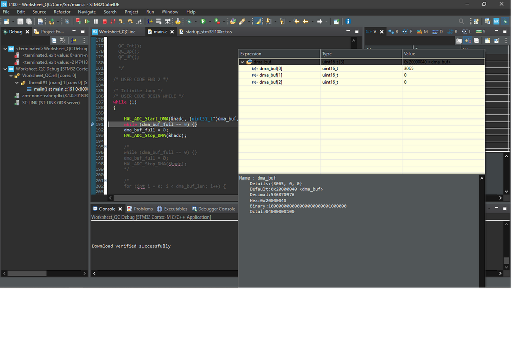

I'm trying to capture single-shot ADC reading from 3 subsequent channels. I'm using CubeIDE and STM32L100RCT6 on the Discovery board, but I have the same results with STM32F103CBT6. I do everything according to that document, but whenever I try, my ADC fills the buffer with only one channel reading, stops, and never starts HAL_ADC_ConvCpltCallback() routine, so it gets stuck in the while loop, which is intended to stops processor and waits for conversion complete:

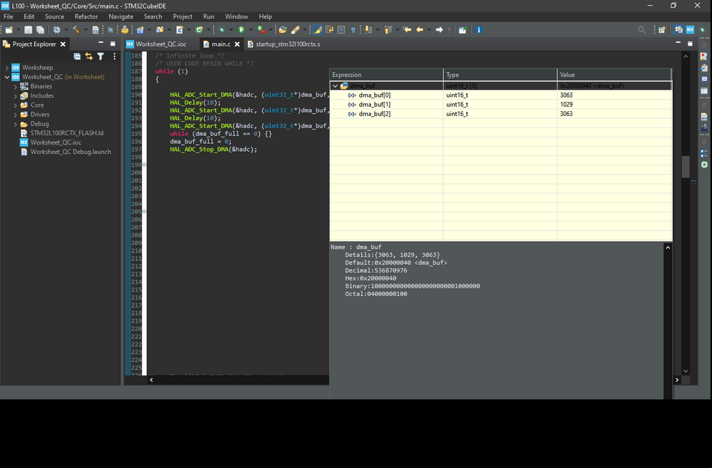

I know it does not look wright, but I've also tried that:
And it looks like it is working, but ADC only reads 2 channels out of 3 and loops (3rd reading should be smaller than 2nd). I attach my whole code below.
Thanks for any help.
#include "main.h"
#include <stdio.h>
/* USER CODE END Includes */
ADC_HandleTypeDef hadc;
DMA_HandleTypeDef hdma_adc;
TIM_HandleTypeDef htim2;
UART_HandleTypeDef huart1;
/* USER CODE BEGIN PV */
bool dma_buf_full = 0;
uint16_t dma_buf_len = 3;
uint16_t dma_buf[3];
/* USER CODE END PV */
static void MX_DMA_Init(void);
static void MX_ADC_Init(void);
static void MX_USART1_UART_Init(void);
static void MX_TIM2_Init(void);
int main(void)
  HAL_Init();
  SystemClock_Config();
  MX_GPIO_Init();
  MX_DMA_Init();
  MX_ADC_Init();
  MX_USART1_UART_Init();
  MX_TIM2_Init();
  /* Infinite loop */
  /* USER CODE BEGIN WHILE */
  while (1)
	  HAL_ADC_Start_DMA(&hadc, (uint32_t*)dma_buf, 3);
	  while (dma_buf_full == 0) {}						//Waiting for DMA to do DMA stuff

Read out and check/post ADC and DMA registers content.

Xses
Thank you for the advice. I've done so and I've figured it out. As usual, it was a pretty dumb mistake. After checking ADC bits I've noticed that Overrun in ADC_SR was high, so I've raised up DMA clock to keep it closer to the fixed ADC clock and it worked, so it was just a problem with DMA not keeping up with ADC. (Dzięki kolego.)
