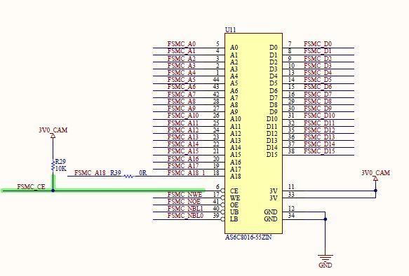

Hi,I have STM32F4 interfaced with the external SRAM sized 512kx16 array. Now what I believe is (Pls correct me if i am wrong), Pointing to Every incremental Address should give me 16bit data. because SRAM is interfaced with 16bit wide data bus (non multiplexed)
For Example: 0x64000000 is the base address of my external SRAM. And I want to write hello, to this RAM, then It should happen like...
on 0x64000000 location, data should be written, 'H' 'E' &
on 0x64000001 location, data should be written, 'L' 'L' &
on 0x64000002 location, data should be written, 'O' 0xff .
And the same is should be getting in read back.
But What actually occurs is
on 0x64000000 location, data iswritten, 'H' 'E' &
on 0x64000001 location, data is written, 'E' 'L' &
is
written, 'L' 'L' &
on 0x64000003 location, data is written, 'L' 'O' &
on 0x64000004 location, data is written, 'O' 0xff .
So If I want to get the write data, I will have to read back 16 bit data from location
0x64000000,0x64000002, and 0x64000
Can Anyone Has the experience of interfacing 512kx16bit array SRAM ? and facing the similar issues ??

Yes, It access two bytes at once.
But, It read-write 1 byte per 1 address location only. Problem is not regarding accessing capacity, sure it is 16bit and I am able to evaluate in my system. Problem is about utilizing memory area, by given number of address lines.
Let me try to make more clear.
I have interfaced the SRAM as per the schematic in attachment.
As you can see, I have used A0-A18 address lines, which is 19, as per simple math rule, total addressable area is 0 to 524287(2^19).
Now as per the data sheet, the SRAM we use - AS6C8016, has the 1MegaByte capacity. But with 19 address line I am able to access only 512KByte memory.
Accessing each address combinations(0x00000000 - 0x0007FFFF) on A0-A18 gives me 1 byte data only, so At present, total accessible memory with this architecture is 512Kbyte.
Posted on February 28, 2017 at 06:31
yes, I can see your diagram looks good.
and the problem is that pins A0-A18 are actually shifted inside the processor to A1-A19 (suggested by Clive)
So you can be sure your addressing is now 20 bits wide,
So the result is that your address range should be 0- 0xFFFFF
please try that,
Posted on February 28, 2017 at 06:36
Thank you very much.
I have already interfaced SRAM with STM32F4 as per the application guide. And It works fine as long as I don't care to use whole area of RAM. This configuration gives me access to only 512Kbyte.
I want to understand where I am making mistake, I have also checked in the manual write operation that I can not access the address above 512k, It will just give me 0xFF, If I try to do so.
Posted on February 28, 2017 at 06:39
Ok. Understood I guess.  Let me try and Will give you feedback. Thanks all for your time.

I assume the issue is solved now. The datasheet i pointed to, explain how the signaling must be done. It's not explain how the MPU handle the byte control pins. I am sure that this are not just placed into the A0 line.
If i have a board that requires external sram, i will check up how the f4 handles this lines.
