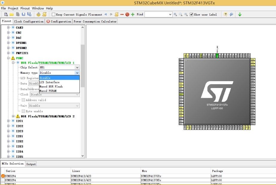

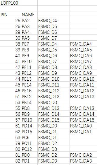

MCU package is LQFP100. STM32CubeMX makes the FSMC bus 3 options: LCD ; Muxed NOR Flash; Muxed PSRAM (fig 1). so Muxed PSRAM is the right choice. In the Muxed mode, the data and address bus is FSMC_DA0, FSMC_DA1,...FSMC_DA15.(fig 2)

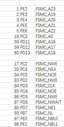

BUT, In the datasheet , the chip has standalone DATA bus FSMC_D0..FSMC_D1..FSMC_D2....FSMC_D15 (fig 2)  and standalone ADDRESS bus FSMC_A0, FSMC_A16, FSMC_A17..FSMC_A23(fig 3). The address bus is 9 bit, it is enough for 30+ registers.  Can I used FSMC in non-Muxed mode for this application? If non-muxed mode is ok, I will save register-to-fpga-out time and fpga layout.

Most probably you can (I am not ST so this is not a hard guarantee), if you don't need a continuous address space. I am using an STM32F407VG in this fashion.

I believe this is simply a misinterpretation of a not-that-well-formulated note. I don't believe there is anything which would prevent non-muxed modes in the 100 pin package; this would be very weird.
IMO that note is there just to avoid disappointment from people who don't read the rest of the DS thus don't realize that the low address pins are not present in that package. Thus, the non-muxed mode *is* usable, but only for a reduced and non-continuous address space. There are applications where this is fully acceptable (this thread is its prime example). I'd suggest to reformulate that note in all relevant DS to say this more precisely.
I also don't believe that FSMC_NE4 mapped at PC4 wouldn't work as expected in the 100-pin package, together with FSMC_NE1 at PD7, so I don't see a reason for the 'only 1 external memory' part of that note either.
And, as I said, I use an STM32F407VG in non-muxed mode, using only A18 to address two registers, while the same note can be found in the 'F407's DS, too.

I don't need a continuous address space.
OK, I think non-muxed will work, so I will try that later. The PCB hardware is not affected by non-muxed or muxed, if I connect all the related pins to FPGA.  If I finish the job , I will come here to finish the discussion .

Starting with CubeMX, it may be possible to select LCD Interface then add needed IOs.
-Amel
