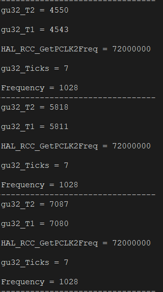

Image 2 : Arduino frequency : 1000 , stm32 captured frequency 1028

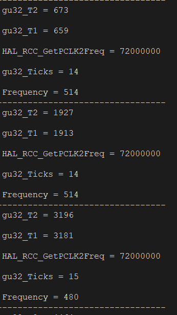

Image 3 : Arduino frequency : 500 , stm32 captured frequency 514/480

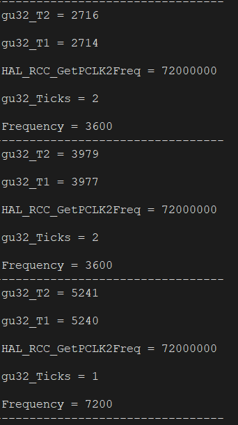

Image 4 : Arduino frequency : 5000 , stm32 captured frequency 3600/7200

It's clear now. You have too little discernment. For values of gu32_Ticks 7,8,9 the calculated output frequency is 1028, 900, 800. There is nothing in between. (You cant get value 1000, because all values are integral.)
