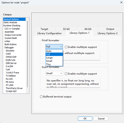

printf fail to print float type
STM32L09
Software tool: IAR Workbench 9.60

int putchar( int ch ){
  while(!(USART2->ISR&0X0080));
USART2->TDR  = (unsigned char)ch;
return ch;
test code:
printf("%d\n",ADC_array[0]);
printf("%f\n",1.234567);
Output on computer:
62615       ----correct
%f             ----incorrect(should output 1.234567)

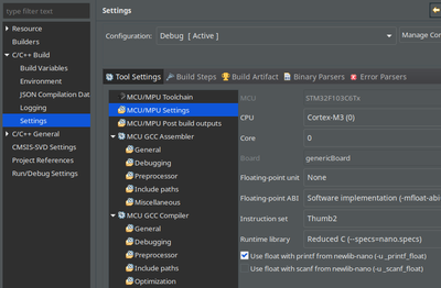

AScha.3
check : project->properties->settings : use float with printf...
3 REPLIES 3
Perhaps need to check box full scanf/printf libraries supporting floating point.
Likely quite large so not enabled by default.
AScha.3
STM32L09
thank you, I found it in this window:
the default is Small, I change it to Full, now it works, I have float printed.
63445
1.234567
by the way, will this configuration increase the hex fill? should I change it back to Small after debugging? so I can save the flash size.
