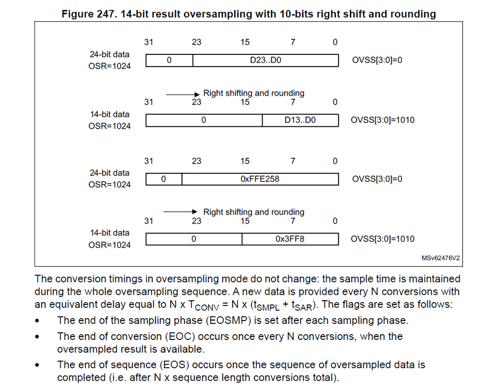

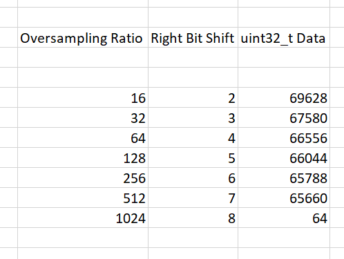

In STM32U5, What is the right Oversampling Ratio for ADC1 14bit to achieve 16 bit. Is there a formula?
Shru2
following is observation with different OR

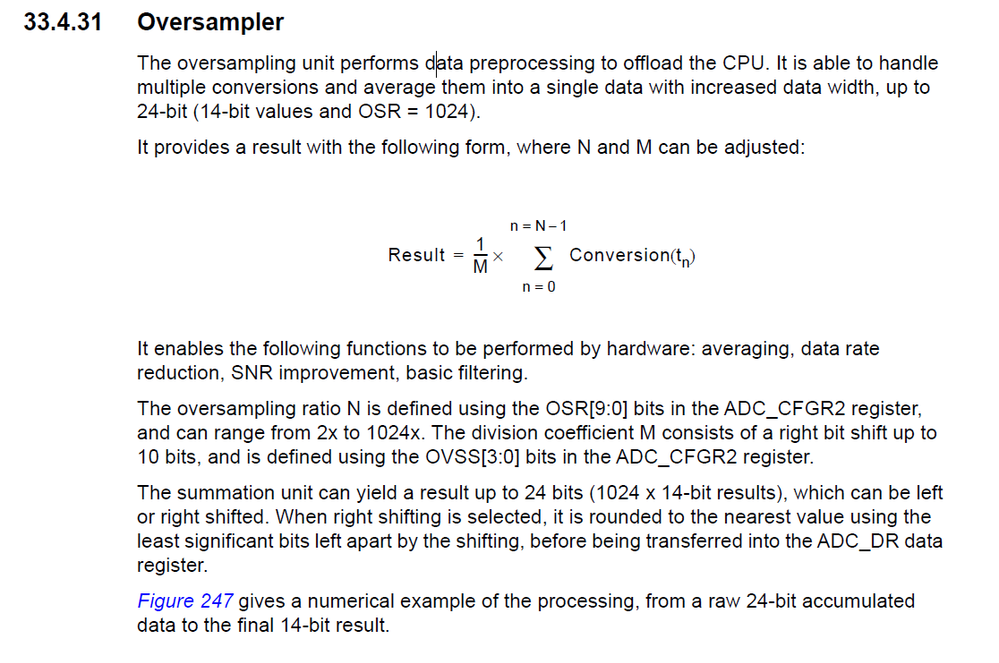

Hello @Shru2​ and welcome to the Community :)
You will find the formula and more details in the RM0456 section 33.4.31:
0693W00000aIaX1QAK.pngIf your question is answered, please select the right answer as “Best�? as this will build that member’s reputation and also help other users to find answers faster.
