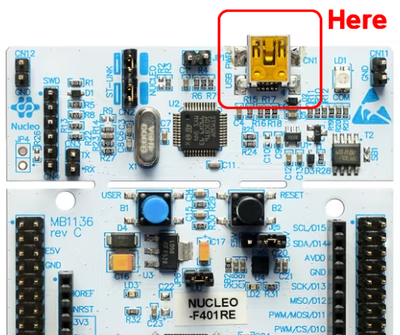

‎2024-07-03 9:02 AM
So you're unplugging the USB cable from the built-in ST-Link on the Nucleo board ?
So long as you don't do that during programming, that shouldn't be a problem.
Probably not a good idea to do it during a debug session.

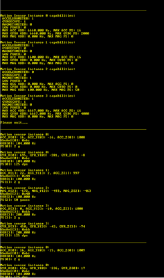

So, when fresh compiled, the code works giving this output:

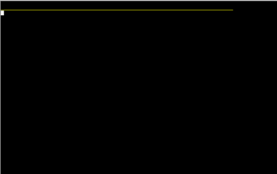

But after that, it will only display this:
