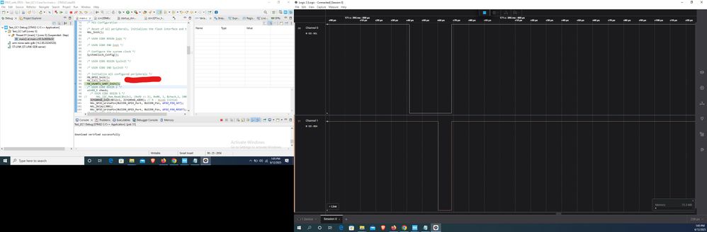

Thanks for responding
I am using only one task in setup.
this line --- HAL_I2C_Mem_Read(&hi2c1, (0x69 << 1), 0x00, 1, &check,1, 100); is properly return check value "234"(0xEA) in bare-metal (non-RTOS) project which is show that sensor is available  to read data, but in RTOS project (i include Free Rtos code bellow) it is reading 8 value of check.Screenshot (213).jpg

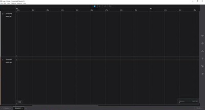

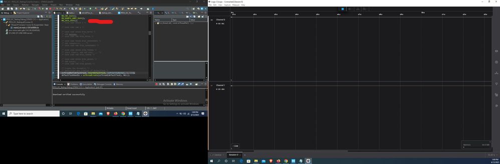

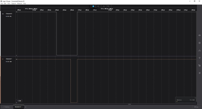

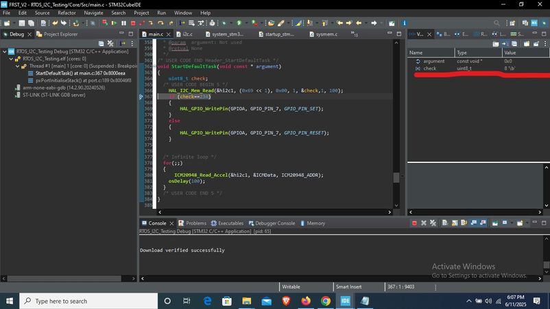

You need to probe what is going-on on the bus using an oscilloscope or a logic analyzer.
You need also to refer to the sensor datasheet to know what that "8" value means!
Try also to declare uint8_t check; global and test.
what you mean by going-on on the bus. and 8 is the value of local variable uint8_t check; if i declarer it as globule variable value showing "0".
You need to check what happens on the I2C bus by probing SDA/SDL lines using a logic analyzer. This is the efficient way to debug the issue.
As the following?:

Try also to decrease the optimization of the compiler.
What if you call :
before calling StartDefaultTask()?
But again you need to probe the SDA/SCL lines and see if you see that magic value "234" when reading the sensor.
It means what is occurring on the physical wires - SDA and SCL - of the bus connections.

I am using logic analyzer and finding this graph that is non rots project  MX_I2C1_Init(); initialize successfully in first image but with RTOS project  MX_I2C1_Init(); not initialized (graph showing in 2nd image with dark theme). Now what should i do because connection is same for both project. i2c is by default configured in rots also. Is there any specific config please mentioned.
So this is the working one, without RTOS:
Yes?
You've only shown the very start here - you need to show the complete transaction.
And this is the non-working one, with RTOS:
Yes?
In that one, I don't see anything happening at all ?
Clearly, if nothing is happening on the I2C bus lines, then there is no communication!
