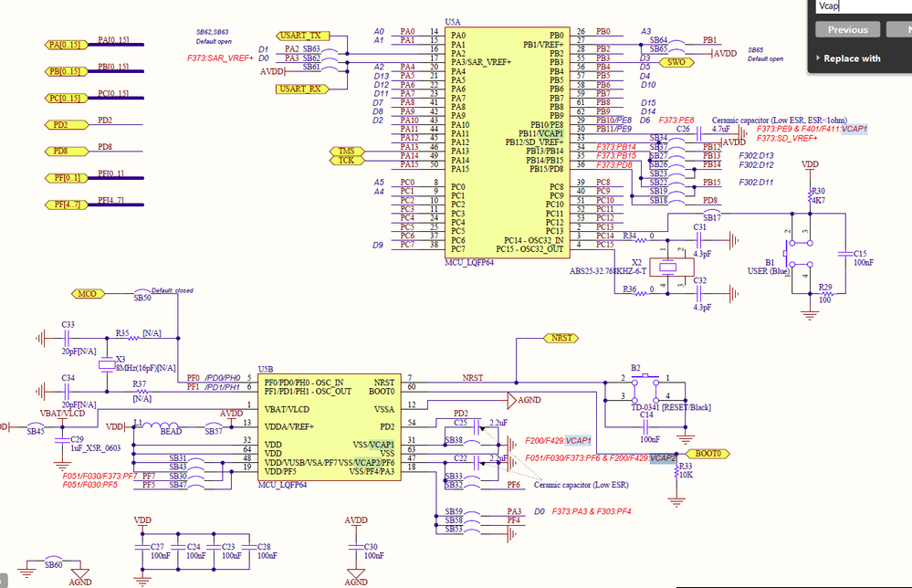

I have a problem with Nucleo STM32F401RE board. For unknown reason the board stopped communicating with PC in debug modes, STM32CubeProgrammer, giving the errors such as: "Error: No STM32 target found!". The PC recognizes the board when connected, however, the PC shows that the board has only 12kB of free space, and inside the drive it contains FAIL.txt file which says the following: "The interface firmware FAILED to reset/halt the target MCU". I have tried the following to fix the problem (unsuccesfully):

  • Checking the connections between ST-LINK and MCU according to schematics. All connections are fine except for STLINK_TX and STLINK_RX which do not seem to have a contact between STLINK and MCU (could this be the problem or am I misunderstanding something?)
  • Checking voltage regulators on board - all of them are outputting correct voltages

  • Both 3.3V and 5V are present on the chip.
  • VCAP1 on pin 30 has a voltage of 2.6V, VCAP1 on pin 31 has a voltage of 0.0V. VCAP2 on pin 47 has a voltage of 0.0V (schematic attached below).
  • NRST is 3.3V at the moment of turning on the board and switches to 0V after a short time.

VCAP1(30) should be around 1.20-1.25V on a working part
NRST should remain HIGH

Would replacing the mcu help?
Doesn’t help :(
