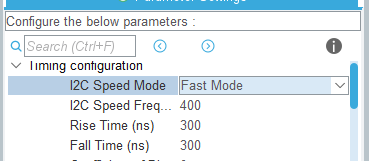

Now that I know the cause, will report it.
In order to communicate with the device I was using, I made a mistake in setting I2C Speed Mode.
(I2C Speed Mode : Standard Mode → Fast Mode)
I'm sorry for confusing you.
