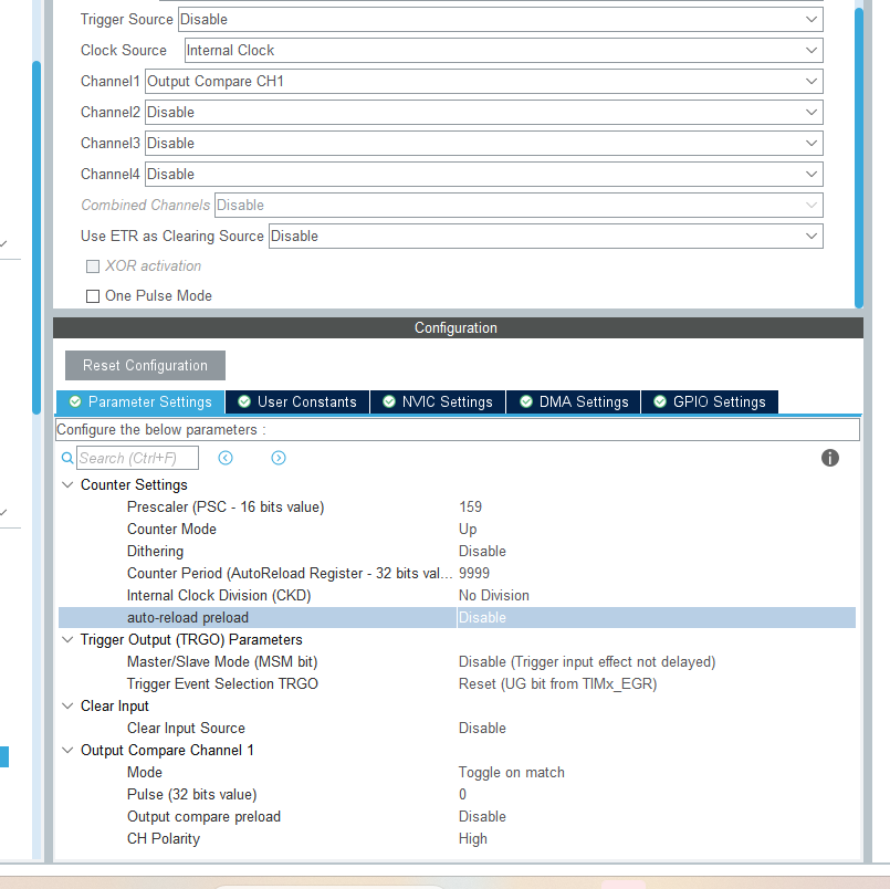

htim4.Instance = TIM4;
htim4.Init.Prescaler = 159;
htim4.Init.CounterMode = TIM_COUNTERMODE_UP;
htim4.Init.Period = 9999;
htim4.Init.ClockDivision = TIM_CLOCKDIVISION_DIV1;
htim4.Init.AutoReloadPreload = TIM_AUTORELOAD_PRELOAD_DISABLE;
if (HAL_TIM_Base_Init(&htim4) != HAL_OK)
Error_Handler();
sClockSourceConfig.ClockSource = TIM_CLOCKSOURCE_INTERNAL;
if (HAL_TIM_ConfigClockSource(&htim4, &sClockSourceConfig) != HAL_OK)
Error_Handler();
if (HAL_TIM_OC_Init(&htim4) != HAL_OK)
Error_Handler();
sMasterConfig.MasterOutputTrigger = TIM_TRGO_RESET;
sMasterConfig.MasterSlaveMode = TIM_MASTERSLAVEMODE_DISABLE;
if (HAL_TIMEx_MasterConfigSynchronization(&htim4, &sMasterConfig) != HAL_OK)
Error_Handler();
sConfigOC.OCMode = TIM_OCMODE_TOGGLE;
sConfigOC.Pulse = 0;
sConfigOC.OCPolarity = TIM_OCPOLARITY_HIGH;
sConfigOC.OCFastMode = TIM_OCFAST_DISABLE;
if (HAL_TIM_OC_ConfigChannel(&htim4, &sConfigOC, TIM_CHANNEL_1) != HAL_OK)
Error_Handler();

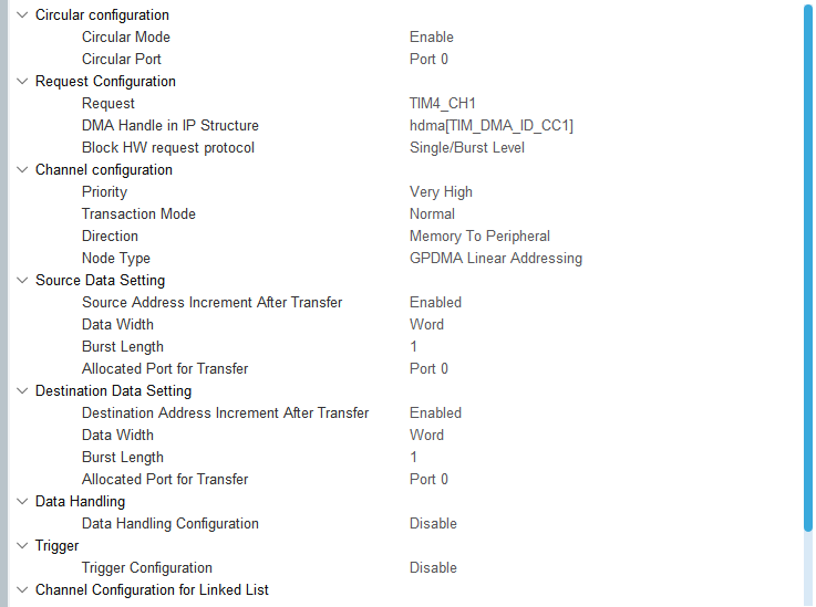

NodeConfig.NodeType = DMA_GPDMA_LINEAR_NODE;
NodeConfig.Init.Request = GPDMA1_REQUEST_TIM4_CH1;
NodeConfig.Init.BlkHWRequest = DMA_BREQ_SINGLE_BURST;
NodeConfig.Init.Direction = DMA_MEMORY_TO_PERIPH;
NodeConfig.Init.SrcInc = DMA_SINC_INCREMENTED;
NodeConfig.Init.DestInc = DMA_DINC_INCREMENTED;
NodeConfig.Init.SrcDataWidth = DMA_SRC_DATAWIDTH_WORD;
NodeConfig.Init.DestDataWidth = DMA_DEST_DATAWIDTH_WORD;
NodeConfig.Init.SrcBurstLength = 1;
NodeConfig.Init.DestBurstLength = 1;
NodeConfig.Init.TransferAllocatedPort = DMA_SRC_ALLOCATED_PORT0|DMA_DEST_ALLOCATED_PORT0;
NodeConfig.Init.TransferEventMode = DMA_TCEM_BLOCK_TRANSFER;
NodeConfig.Init.Mode = DMA_NORMAL;
NodeConfig.TriggerConfig.TriggerPolarity = DMA_TRIG_POLARITY_MASKED;
NodeConfig.DataHandlingConfig.DataExchange = DMA_EXCHANGE_NONE;
NodeConfig.DataHandlingConfig.DataAlignment = DMA_DATA_RIGHTALIGN_ZEROPADDED;
if (HAL_DMAEx_List_BuildNode(&NodeConfig, &Node_GPDMA1_Channel6) != HAL_OK)
Error_Handler();
if (HAL_DMAEx_List_InsertNode(&List_GPDMA1_Channel6, NULL, &Node_GPDMA1_Channel6) != HAL_OK)
Error_Handler();
if (HAL_DMAEx_List_SetCircularMode(&List_GPDMA1_Channel6) != HAL_OK)
Error_Handler();

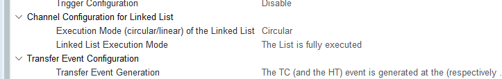

handle_GPDMA1_Channel6.Instance = GPDMA1_Channel6;
handle_GPDMA1_Channel6.InitLinkedList.Priority = DMA_LOW_PRIORITY_HIGH_WEIGHT;
handle_GPDMA1_Channel6.InitLinkedList.LinkStepMode = DMA_LSM_FULL_EXECUTION;
handle_GPDMA1_Channel6.InitLinkedList.LinkAllocatedPort = DMA_LINK_ALLOCATED_PORT0;
handle_GPDMA1_Channel6.InitLinkedList.TransferEventMode = DMA_TCEM_BLOCK_TRANSFER;
handle_GPDMA1_Channel6.InitLinkedList.LinkedListMode = DMA_LINKEDLIST_CIRCULAR;
if (HAL_DMAEx_List_Init(&handle_GPDMA1_Channel6) != HAL_OK)
Error_Handler();
if (HAL_DMAEx_List_LinkQ(&handle_GPDMA1_Channel6, &List_GPDMA1_Channel6) != HAL_OK)

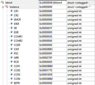

problem
Only the first value has an effect
The following are all 10ms cycles for level flipping
The CCR values of other channels have also been changed
我想知道如何在STM32U575中实现DMA+PWM比较输出

caiChangKun
Using GPMDA to perform PWM comparison output on STM32U757. Only the first pulse conversion period is 3ms, and the others are 10ms. Additionally, the CCR values of other channels are also modified.
我想比较GPDMA+PWM的输出,在固定时间段内进行多次电平翻转。
Sarra.S
Hello @caiChangKun
This could be related to the config of your TIM/DMA, make sure ARR  is strictly greater than the CCR value
Yes, my ARR value is greater than the CCR value. The issue is that only the first 3000 value is effective. I am only sending the CCR value to channel 1, but the values of my other channels are also being changed. Why is that?
