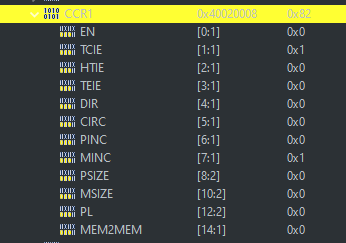

I work on basic i2c example with DMA using HAL library. When i observed data in the debug section that data read correctly but DMA did not rise flag TCIF(transfer complete flag). What might be reason ?

//  __HAL_DMA_ENABLE_IT(&hdma_i2c2_rx,DMA_IT_TC1);
  __HAL_DMA_ENABLE_IT(&hdma_i2c2_rx,DMA_IT_TC);
  hi2c2.Instance->CR1 |= I2C_CR1_RXDMAEN;
  DMA1_Channel1->CNDTR=8;
  /* USER CODE END I2C2_Init 2 */

Cube's interrupt handler might have already cleared TCIF. Instrument the real interrupt service routine (i.e. not the callback).
I updated codes above. I also try like this and the problem is interrupt occurs 1 time and when i clear the flag , interrupt did not occurs any time .
