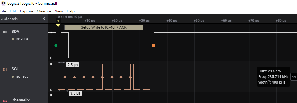

So this is the picture from a scope:
0693W00000FBfMeQAL.png400 KHz is 1/width of the SCK low state = 1/2.5us.
The frequency of SCK pulses from edge to edge is 1/3.5 us = 285 KHz.
Is this how it should be, or it should be 2.5 us from edge to edge?
Isn't this a LA rather than an oscilloscope? Post a picture from oscilloscope, that would be very interesting to see.
What is the value of the pullups? How many slaves are there on the bus, how long is the bus? (Read, what are the R and C to the rise time?)
3.5us is a bit excessive, as I wrote above, I'd expect something more around 3us. However, if you'd used only the internal nominally 40kOhm pullup, with a couple of tens of pF it may produce quite well a few hundreds of ns rise time.

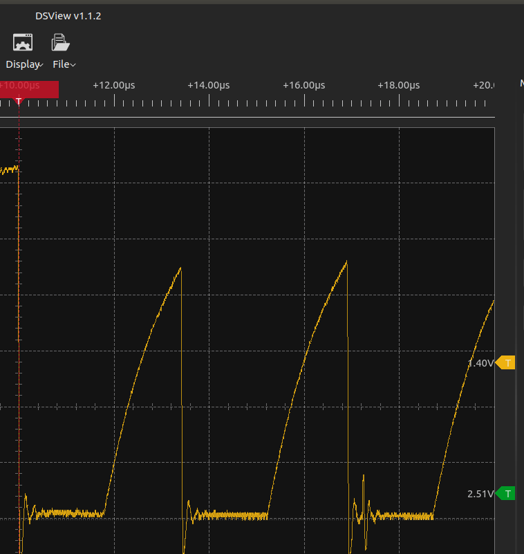

Here is scope with parameters below

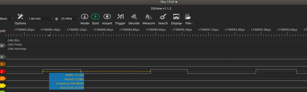

And picture from another logic

OK so that rising ramp explains that all. The pullups are grossly inadequate, decrease them by at least one order of magnitude. And please don't tell me you are using only the internal pullups.
