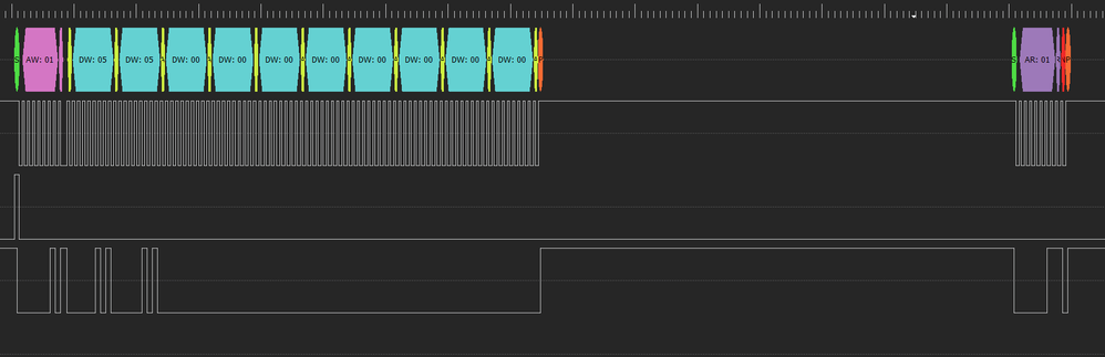

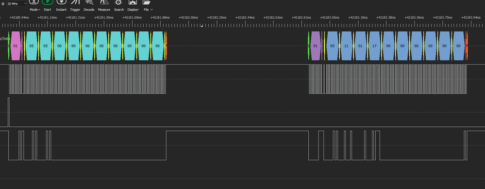

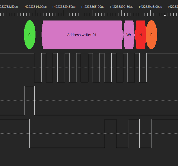

This is what i see at the logic analyzer.
Pictures goes from all good -> moment of terror -> continuously terror
What can cause HAL I2C to stop working like this?
How can i do a full reset of HAL I2C ?

There was a variable type wrongly defined in my timer function, which caused a continuous I2C reset after 1min and 6 seconds.
But even when i cleared that issue i was not completely out of the woods yet, if i paused the program trough the debugger pause button, i did see the I2C communication was not restoring itself. Once the communication broke, it was broken for good. (endless loop in I2C1_IRQHandler). I know this is not a real life situation, but i do like that communication restores when something goes wrong.
So i looked for a solution and found this one :
At the main program i start a softwaretimer each time HAL_I2C_SlaveTxCpltCallback and HAL_I2C_SlaveRxCpltCallback is called.
in I2C1_IRQHandler i check if the timer elapse , this happen when it's endlessly interrupted , when this happen i reset the I2C module. This seems to do the trick, now i can pauze and run , the I2C communication will always restore itself.
