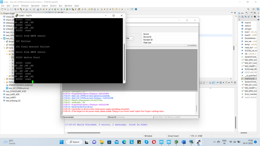

As I was continuing with my effort to read the sensor values using C8...I observed that when I do the HAL_write and HAL_Read...there seems to be values which are not coming out of sensor properly..
attached is the code for the same.I am seeing values like dd, dd once I read from the memory.
HAL_write is passing..I am comparing the same result with Rpi when I connect the sensor..so it is not matching with Rpi..Let me know your thoughts on this.

It's time to take the logic analyzer out of the drawer and look at the bus to see what's going on there.
AScha.3
yea, i said 3 days ago:
if still not working - its time, to look at the signal:
take DSO, 1 ch sck , 1 ch sda ; trigger on clk.
then show, what happens on I2C lines.
but he prefers to play blind cow . :)

sorry I had updated ...I2C is working fine...and I am also able to get the version of the sensor fine.
After which I am trying to read the status ready ..where I am not seeing the flag .
if I just enable version number all is fine..but when I try to get the get ready flag there seems to be problem...more to do with I2C_Mem_write and Mem_read...any suggestion with the way it is called kindly let me know.

RShiv.1
Senior
it looks more a pointer management issue I guess...I am able to get the version number of the sensor fine if I run only that..but when I enable get ready flag ...even the version number values changing..
let me know..
If I get this properly I will be able to read the perodic mesurement as well as the actual values from sensor...

I tried with this which says
only dddd
